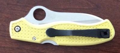

I got my Atlantic Salt in today, and the first thing I noticed was how thin the handle is. That should make it a lot easier to carry and easier to make buoyant.

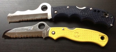

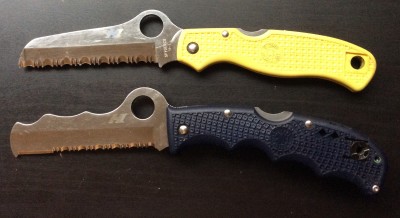

Anyways, I got the Atlantic because I like choils, but I have no need for the blunt tip (I already have an Assist Salt that I use for rope access work). I'm going to re-shape it into a 3.5" spear point so it's better for general use and cutting up fish.

Drawn this way, the tip sits about 3/16" below the top of the handle.
I had plenty of wharncliffe experience back when my only knife was a Kershaw Leek (that was before I found Spyderco). I prefer some belly for almost everything I do.

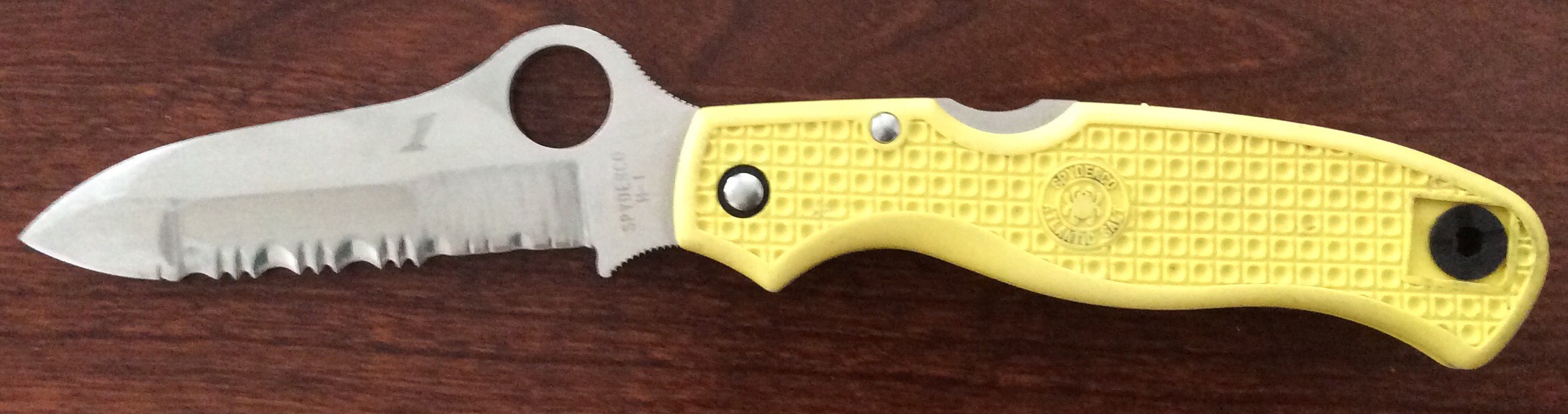

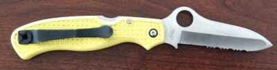

The edges will become more refined as I use and sharpen it, but here it is.
AHAB
aicolainen
Posts: 2594
Location: Norway
Re: Spear Point Atlantic Salt
Post by aicolainen »
Nice job!

Mmmmh, nice one ! And nice swedge you got there. It gives it character.
May I ask what tool(s) you used for the blade shape modification ?
I got this puppy just for the clip for another knife, and it might be a fun project (to add to my every growing line-up of fun projects).
Vamais
Posts: 217
Joined: Thu Jan 12, 2023 7:07 pm
Location: Earth
Post by Vamais »
Thanks!
Roughing was done with a 60 grit belt grinder, quick touches to the belt followed immediately by plunging into water to keep the blade cool.
Everything else was done with diamonds. I think I used a 180 grit plate and a coarse diamond file to finish the tip. An extra-extra-coarse DMT file was used for the regrind by the handle. I've always done everything freehand.
AHAB
