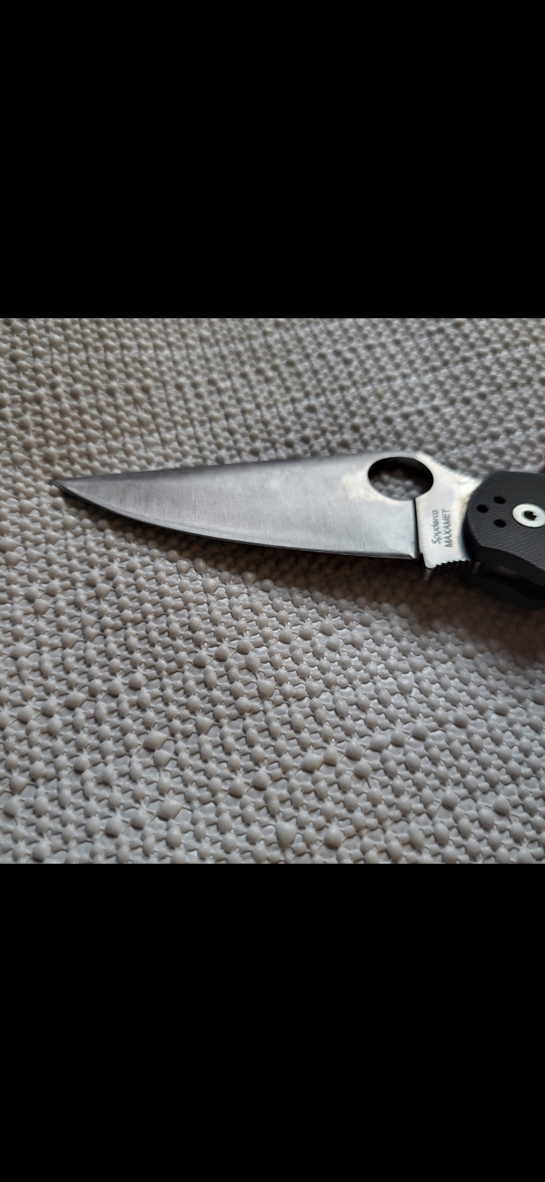

Reground my maxamet pm2 yesterday. I only spent a little over an hour on it. Without an apex it cuts papertowel based on blade geometry. I haven't set an apex yet. Still deciding if I want to go thinner.
