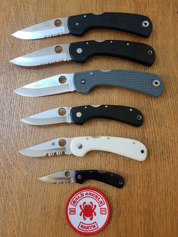

Larry_Mott
Posts: 2742
Location: Helsingborg, Sweden
Re: Is it getting close to a new Goddard sprint run?
Post by Larry_Mott »
Superblue would be fantastic, but even VG10 it would be great to see another Goddard!
Posts: 17078
Very nice grouping Larry ! MG2
