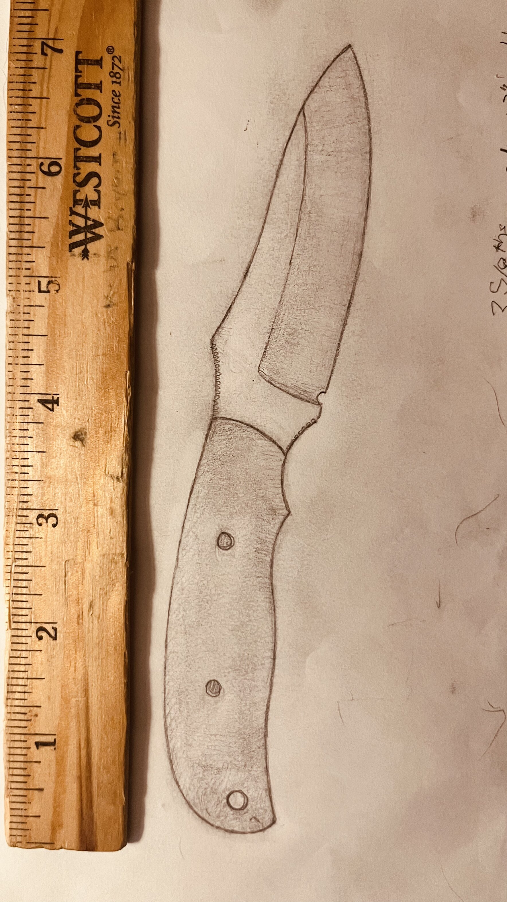

Hey all,
I just figured I’d share a look at this design I’ve been working on for about a week here and there. I’m quite proud of it, and wanted to see what kinda feedback I might get. Obviously some of my design language showcased here is inspired by spyderco. Some specs on the knife drawing:
Edge length: 3”
Full blade length: 3 5/8”
Handle length: 3 3/4”

I would also love to know if anyone’s eye picks out something they think could use improving, I’m open minded to tweaking it

Have you seen the Spyderco Sjoerd? Very similar blade shape and specs but your handle appears to be a little more substantial, which I think I'd like better.

remnar wrote:
Sun Jan 15, 2023 10:48 pm
https://www.knifecenter.com/item/SPFB49 ... ron-sheath
I have not seen this version before, today I saw the thread in general of the drop point/sheepsfoot version. I would have to disagree that this blade shape and my design are very similar, most prominent feature I see they both share is a Saber grind and a finger choil. The stok fixed blade looks like a nice design too, without having held one though, i don’t think i really like how narrow it gets down at the choil.

Tristan_david2001 wrote:
Sun Jan 15, 2023 11:07 pm
I agree with you about the choil. Your handle design looks more comfortable and usable but it is hard to be sure without an in-hand comparison. I do think your design looks very good. Nice job! :bug-red-white

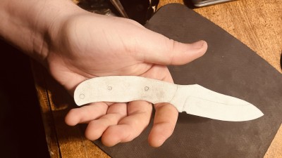

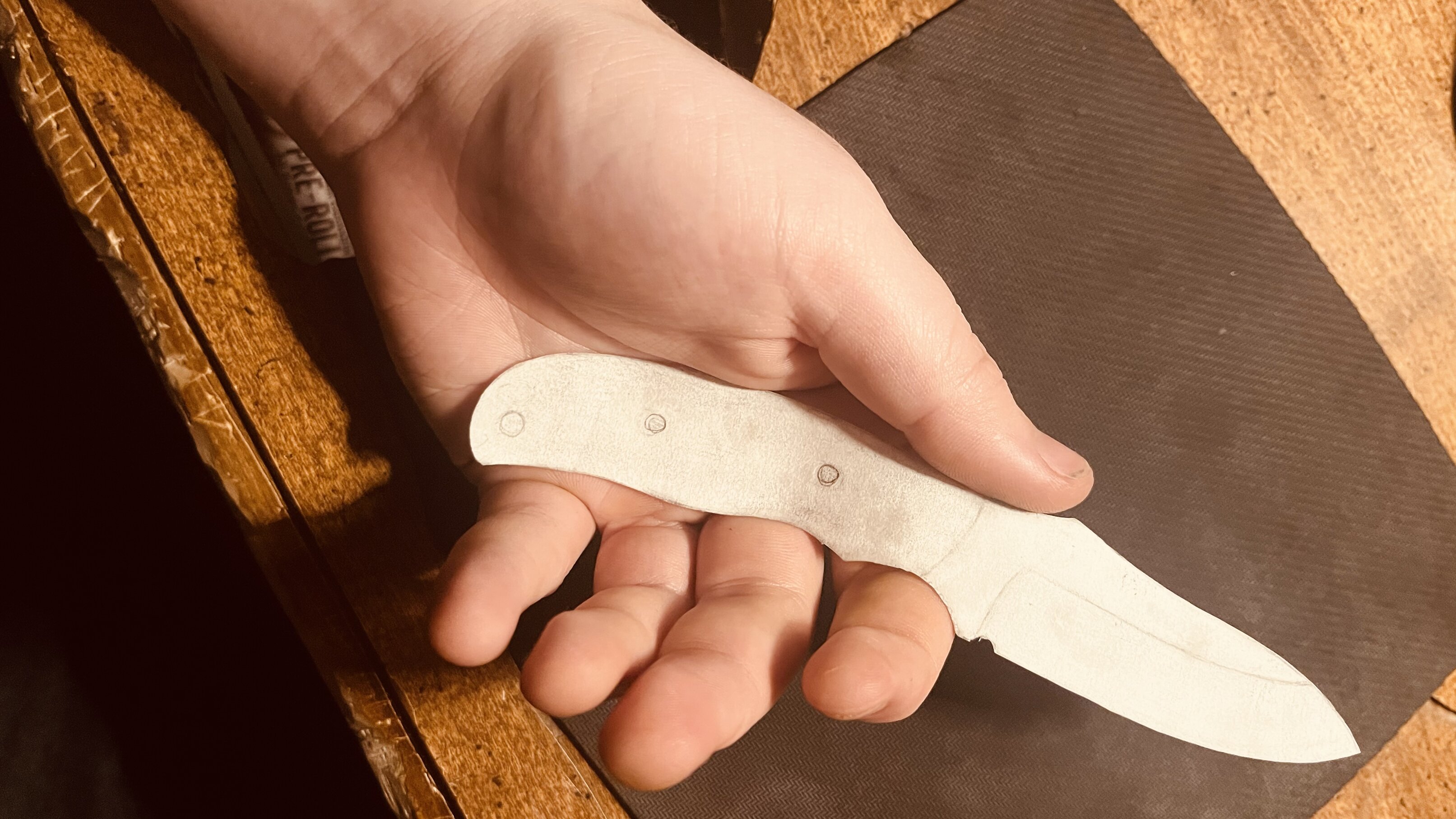

I just cut out the design to get a somewhat feel for how it fits the hand, I wear a men’s glove size xl for reference. I’d say judging by the how the outline feels to hold it would fit my hand very very well.

Tristan_david2001
Posts: 1297
Re: EDC style fixed blade (sketched concept design)
Post by Tristan_david2001 »
remnar wrote:
Sun Jan 15, 2023 11:29 pm
I’m glad you like it remnar, your feedback is greatly appreciated!

How would you plan to attach the handles to the knife? A pointer I received from someone who apprenticed with Fiddleback Forge is for your first and last pins to be close to the blade and butt of the handle. This is to reduce the potential of the scales separating from the tang if you’re pinning and epoxying the scales. I don’t remember the maximum distance he recommended offhand, but it was in the ballpark of 1/2 or 3/4 of an inch.
Your lanyard tube is placed well, but the front pin might be better if moved towards the blade a bit. With the middle pin moved to keep the visual balance.
If the plan is to use screws to allow the scales to be removed, I’m not sure whether the same theory applies.

Rusty_Shackelford wrote:
Mon Jan 16, 2023 11:41 am
Hey rusty, I would prefer using a male&female screw to attach the handle scales. that’s a good point about the placement of the front pin being a little too far from the top of handle, maybe adding a 3 pin and rebalance the spacing would
Be an improvement?

the former version of the design I had a ffg on the blade. I like how the lines look with this grind as well

Very nice design you have there, Tristan. It looks like it would be very comfortable in-hand. I like the slightly negative blade angle as well. Nice work!
For handle hardware, you might want to check out KnifeKits.com. They have a pretty nice selection of fasteners in various sizes and configurations. Here's a link: https://www.knifekits.com/vcom/knife-ma ... 60_83.html

I would move the handle to fit the tang a lot more than you have it at the front especially at the bottom where your finger is.

Hey standy99. I’m really not sure what you’re suggesting be changed. Nice knife you got there though
Sun Jan 15, 2023 11:32 pm
In the picture above extend the handle a bit where your first finger is to go a bit closer to the blade.
Couldn’t do this that well on my iPad, but like here…..
It will be more comfortable in the hand with a bigger handle.
