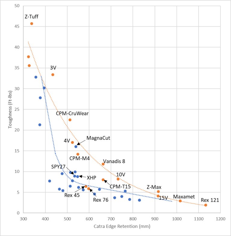

Re-upping one of Dr. Larrin's graphics that gives some context for T15. IIRC, Larrin drew the curves in the neighborhood of the best examples of tool steel, rather than through all the examples.* In other words, I don't think the curve represents a quadratic regression curve attempting to fit all the tool steel points. If true, then I suspect that T15 is not necessarily a laggard that's "behind the curve," I'm guessing (trying to fit a regression curve by eye, yes, dangerous) that T15 is probably about where you'd expect it to be for toughness, given its CATRA scores. Bested by Vanadis 8, but outshining Rex 76, in this graphic.
*A little confusing since the stainless steel curve appears to be more in the swarm of points. But I'm still guessing these are not regression-fit curves, since Dr. Thomas didn't include the formula for the line. If they were regression curves they'd probably have a formula attached.

I think people get caught up on charpy toughness a little too much. It doesn't really correlate to edge stability in my experience. It does a good job showing what happens at the limit but not below. There's two failure modes for steel ductile and brittle. If the steel is ductile it will deform before it fractures giving higher toughness numbers. A brittle steel will just hold form until failure resulting in lower numbers. I think what happens before the limit might be more important than where that limit is.

Interesting that Rex45 and Rex76 are close neighbors on that chart. Two of my absolute favorite steels.
I used to cry every night that there was no Rex-45 mule, but the Rex-76 mule took all the tears away.
Cutting a nail and a lateral deformation test is better for a knife steel test.
I cannot speak to your other points, but I do find it curious that many peoples favorite steels fall right in between the two curves.
