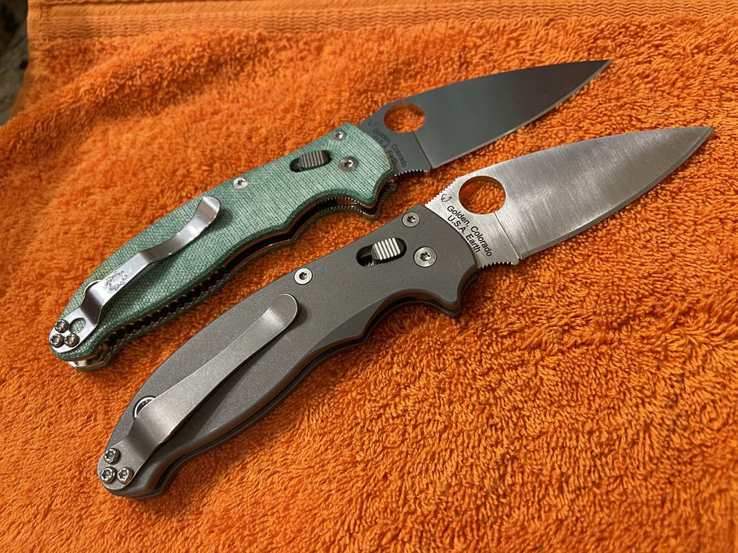

My favorite Manix mod is to upgrade Manixes having nice steels with Rockscale Designs linerless scales. This mod immediately transforms an already ergonomic knife into one that feels perfect (to me) in hand. I've done this with two G-10 Manixes (Manices?), one in Cruwear, another in 15V. I modded an S110V LW as well, discarding the FCRP scales. I'd like to say I've used the heck out of these knives, but I haven't.
My second favorite mod is the Ti ball cage. IMO it definitely provides better purchase than the plastic one, and like LB said, it just looks right with scales other than FCRP.
Next is replacing the strong OEM spring with a weak aftermarket spring. Combined with the Ti cage, this makes opening and closing with one finger or thumb a cinch, almost scary easy. As I said, I haven't used these knives hard, so I can't comment on whether the blade would tend to unlock in hard use. I'm leery enough, though, that I'm considering changing them to medium springs.
The OEM Spyderco clip is a genius design, but I can almost always find an aftermarket replacement that fits my grip better. My very favorite is MXG Gear's model #101061, a non-deep-carry Ti clip that sort of mimics the OEM clip but is a little longer and flatter, without any abrupt bends. To me it's perfect for the Manix and PM2, and it's my preferred clip for any Spyderco with the familiar 3-hole pattern. It's shown below on the Cruwear Manix.
The other Manix in the pic is a formerly base model sporting TeroTuf scales from Fireside Company, as well as a silver Ti cage that looks black in this lighting. TeroTuf feels like canvas micarta, but comes in the seafoam color shown plus several other non-typical Spydie colors. There seems to be more variety in TeroTuf colors than micarta, but less variety, if any, in texture.

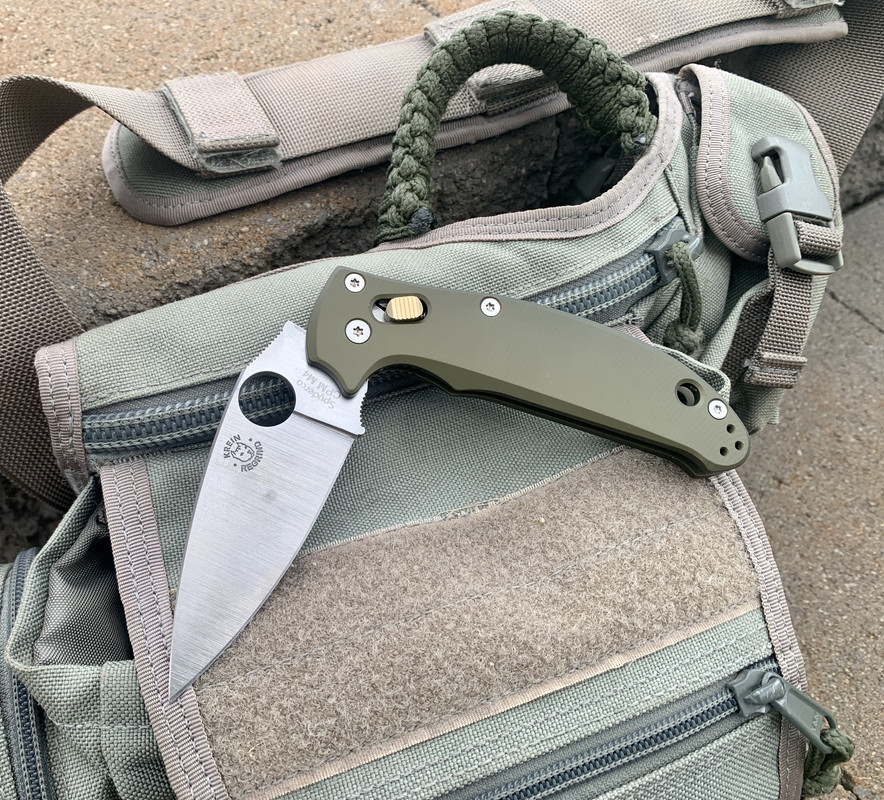

Applied Weapons Technology makes aluminum scales for the Manix 2 that don’t use the liners or the lanyard tube. They come with some extra hardware which adds a screw to the butt end of the knife. The lanyard hole is integral to the scales.
