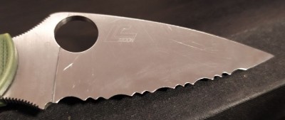

This was kind of overdue, my first time sharpening a SE blade. Since I own this knife, it was in my pocket approximately 80% of the time.
This was before
Every tooth was bend. Some more than the others. Does not look too bad in the pictures but one could feel it without a doubt. The PE part of the blade has been sharpened before.
This is after
The teeth are still a bit pointier and I needed more time to remove the burr, than I have expected. But now it is shaving sharp and ready to be back in my pocket.

Senfkarte wrote:
Wed Nov 09, 2022 12:36 pm
This was before
This is after
You seem to have done a nice job ! I have to admit that removing the burr on a SE knife still takes me more time than on a PE knife, because I often have on small spot or two where the burr remains and the rest of the edge is ok.
I acquired a dragonfly SE in H1 and I really do not like how it cuts, I guess I have to soften the peaks but it is an operation I have yet to try on a SE knife. I might just let it live its life until we get there.
