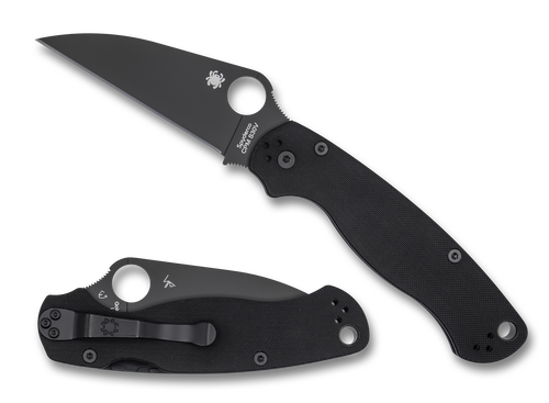

@ Evil D … have you done a mock-up of them closed? my only reservation would be the significant height that would result from all that blade riding outside the handle when closed.

That is a good point. The Rock Jumper is like the Manix in that it takes up a lot of real estate in pocket. I think a more practical grind would be to abandon the gradually sloping curve to the point on the spine that a traditional Wharncliffe has. A more dramatic drop to the point on the spine makes for a better footprint in my opinion and looks better. Think of the recent PM2 Wharncliffe from Cutlery Shoppe.

On Edge wrote:
Fri Jul 29, 2022 7:09 pm
Well this is where the "oversimplification" part comes in because that's need to change the blade kick and/or the inside of the back spacer to allow room for the edge to close into the handle.
This pic just shows the utility blade hitting the handle.
I'm sure it would need to be a bit wider when closed but the potential positive there is that the whole thumb hole could be exposed out from the handle. This happened on the two Caribbean blade shapes too, the sheepsfoot thumb hole is a bit more accessible.

JSumm wrote:
Fri Jul 29, 2022 7:29 pm
It's only partly about the slope of the spine and more about the kick, especially on a back lock since it has a back spacer. On a Para 2 they have more freedom with where the blade stops inside the handle as long as it doesn't interfere with the lock tab. On a back lock the edge will hit the back spacer so the kick needs to be changed. I'm sure the edge couldn't be as low/in line with the finger choil as I have it mocked up.
Posts: 6523
Re: Wharncliffe Native 5?
#47
Yeah, I guess I meant the spine shape being less semi-circle(ish) and more of a straight line (drop) up until the point where you want to reinforce the tip.
I think that looks better and slims down the closed profile.

I'm no expert, but this is what I see.
If you compare a wharnie backlock model next to a the same non-wharnie model side by side (Delicas in my case), you may notice that the ricasso is a bit taller on the wharnie.
If you compare them open and closed, you'll notice that the orientation of the bug on the blade is the same when open, but slightly different when closed. Say the motion of the normal Delica blade when opening is 170 degrees while the wharnie is only about 160 degrees (both vague estimates on my part, I didn't measure, but hopefully you get the idea). The wharnie doesn't close quite as far.
The tip between the two is in about the same place, but the normal one's blade goes quite a bit further into the handle when closed because of the belly.
Since the back lock bar acts as the stop pin, the lock bar could be modified instead. It could be taller where the ricasso/kick touches the lock bar when closed, thus kicking the blade up a little so it doesn't close as far. Then the tip could be in the same place between both models.
My point is that I don't think that it is necessary to modify the handle. The blade and/or lock bar could be modified to make a wharnie happen with the existing handle.

On the Chaparral, the integral stop pins act against the liners. I don't think the kick touches the lock bar. So I don't think either of the solutions in my previous post work on the Chaparral. I think the liners need to change slightly where the stop pins touch them on close so the wharncliffe blade doesn't close quite as far.
