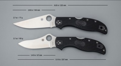

I really liked this pic from the Spyderco Byte. It looks like the handle is just barely bigger yet it packs a decent amount more edge length.

Yes that was one of the first things I noticed too , comparing both in hand . Personally I can easily carry both variations without complaining about ergonomics . Like you I like how they took advantage of the handle length on the XL to enhance the blade length to the maximum . Dan

It’s almost as if the blade got stretched.
And, I do like it, just as I do my PM2s and Millies.
But, has the “drop-point” (and its get-to-the-point intention) now replaced the Stretch’s “modified drop-point” (and its less hurried, more graceful line)? I’ve used quotes here to suggest inconsistent meaning; Spyderco has said the Military Model and PM2 have a “modified clip-point blade”…
The ”modified drop-point” of the Stretch is, of course, a smart way to transfer some strengthening thickness to the tip of a “drop-point” (or is it indeed just another kind of “modified drop-point”, like a “modified clip-point”?) without adding weight.
Might a longer blade not want such strengthening, even at the cost of some pointiness, as earlier Stretches evidently wanted?

You are making a good point.
I can't really weigh in since I don't have the XL (yet...), but it could happen that I'd like to have an a bit stronger tip, especially in SE (again, tip more pointy and fragile due to the chisel grind than in PE).
And right, lengthening a blade normally makes the tip more acute, if it still starts from the same blade stock thickness due to the usually more acute "tapering angle".
And, if blade height at the heel of the blade, straight spine and belly remain the same, the longer blade will be more acute also when looking at the flat of the blade, just by geometry (can be seen for example also with PM2 cs Para 3)
But then: Tips are always a compromise between pointy (which is actually very useful) and robust...
