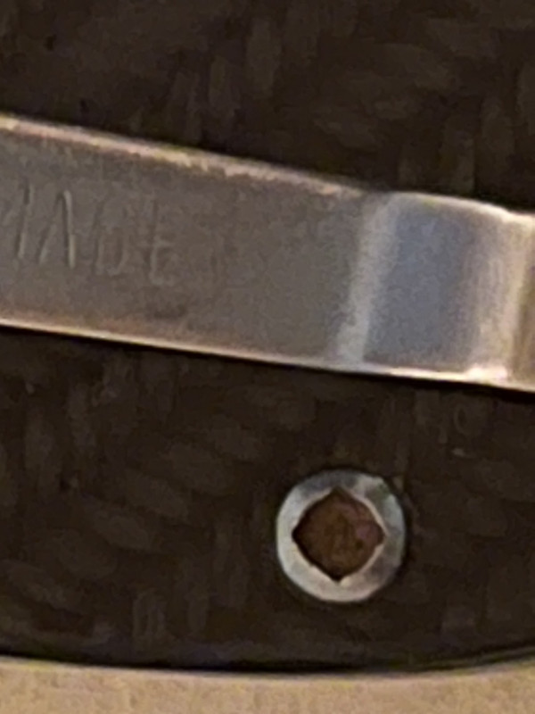

I have a C22 and, even though it needs some TLC, I have left it untouched because I can't get up the gumption to deal with the tiny, unusual screw heads. A really useful mod would be replacing the existing screws with Torx-heads. The C22 was made in Switzerland, which probably still means M2.5 or M3. Here's a picture of one of the heads, magnified 10X:

Thanks for your info. It pointed me in a good direction. The screws on the C22CF take a T6 torx bit and the dimensions seem to be more in line with an M2 sized screw that is 4mm in length.Giygas wrote: ↑Mon Mar 21, 2022 5:15 pmThe length is the least important, that can always be changed.
What's the diameter?
Its almost definitely gonna be M2.5, M3, or 2-56 threaded. It was made in Japan, correct? If so, then my money's on M2.5 or M3.
Do you have a pm2 or para 3? Those have 2-56 clip screws so you can try threading one in. A lot of Taichung made knives use M3 (mantra and Amalgam for sure, probably a ton of others), so that could give you an M3 screw to try.
As for removing the rounded screw, that's gonna need to be drilled out. You could cut a channel into the head and use a flat blade screwdriver, but that's gonna damage the scales, and you'd still need to melt the thread locker (which I'm assuming is what caused the problem in the first place)
Diameter is approx. 2.1 mm but that includes the threads.
Head height is approx. 1.1mm
Head Diameter is approx. 3.6mm
I appreciate the info. Im going to start there and see what happens.
