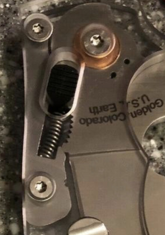

doesn't the cbbl necessitate the choil?
Re: What about Manix2 a Manix2 XL without choil?
I'm pretty sure it could be designed around with an internal stop pin like the Chap if the choil is normally what prevents the edge from contacting the handle.
I'm not normally super hung up on edge to handle ratios but the Manix series is pretty inefficient in this respect. My mock-up was based on tracing around a Manix XL rather than free handing it, so that's how much cutting edge such a design would offer.
not my picture, but it shows the lock mechanism well in the closed position...
it looks like the choil cutout helps with clearance for the cbbl at least a little.
The ball seats into a notch on the tang. I don't see why that notch couldn't be hidden under the handle when opened like it currently is with the choil.
yeah. it just looks like the blade would hit the spring if it went back farther.

Looking at my Manix XL it appears the ball itself could serve as the "kick" for the cbbl.
They'd definitely have to do some tinkering to make sure the blade doesn't hit the edge though, good observation lb93.
This is exactly what I meant in my first post here.
It seems like a choil-less blade could collide / not fit into the handle together with the CBBL - at least if the latter sits in the handle the way it does in the Manix now.
