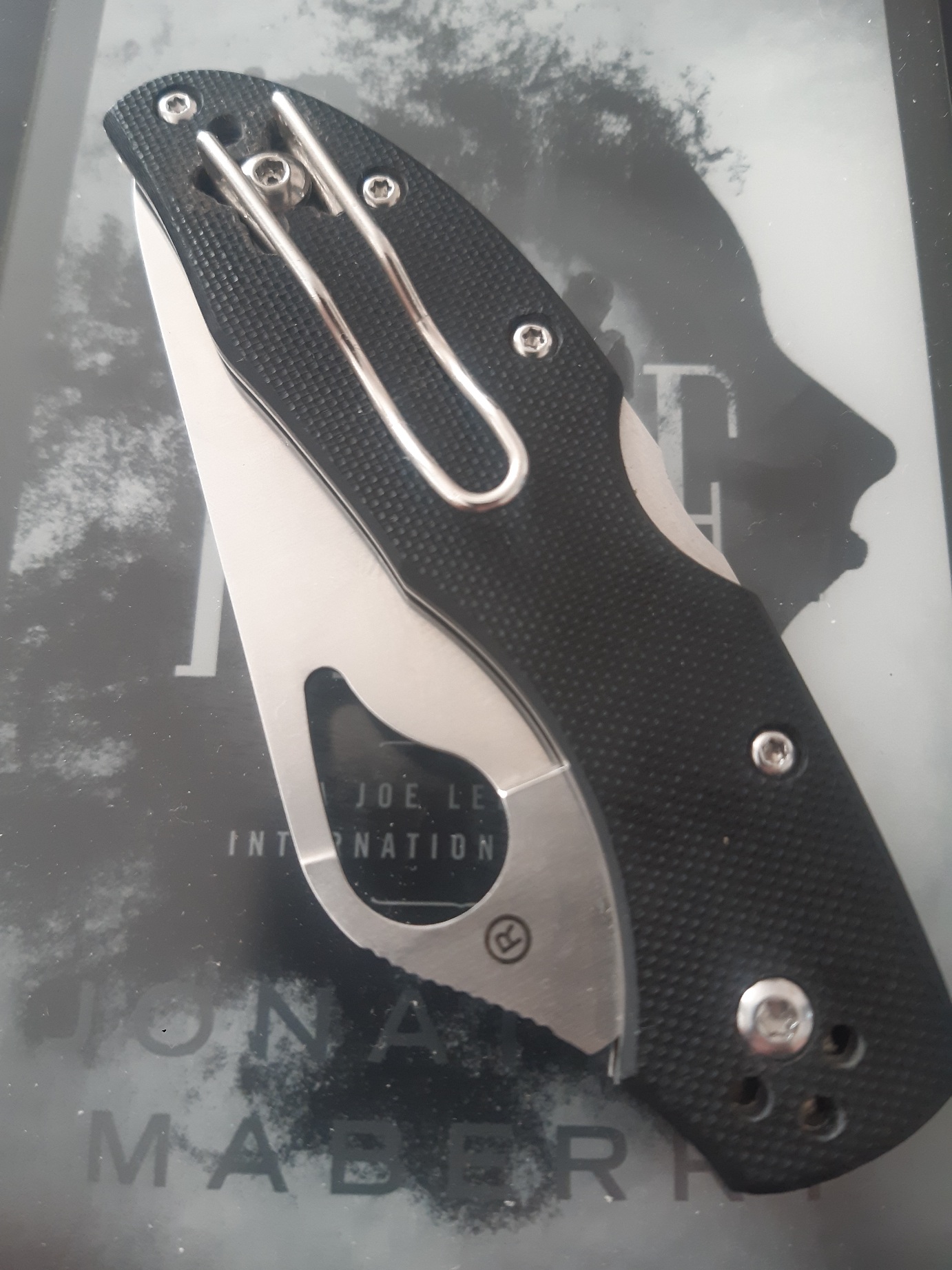

I had to put a wire clip on after catching my knife on a bench and destroyed the screw holes. Lucky I had a wire clip and bolt from a broken dragonfly 2. A little cutting and I'm quite pleased with the result ( it is my work knife so not perfect) now I wish all G10 meadowlark's had the wire clip
Bemo
Posts: 1299
Location: Boise Idaho
Re: Anyone modify or improve their Byrds?
Post by Bemo »
Great job!
