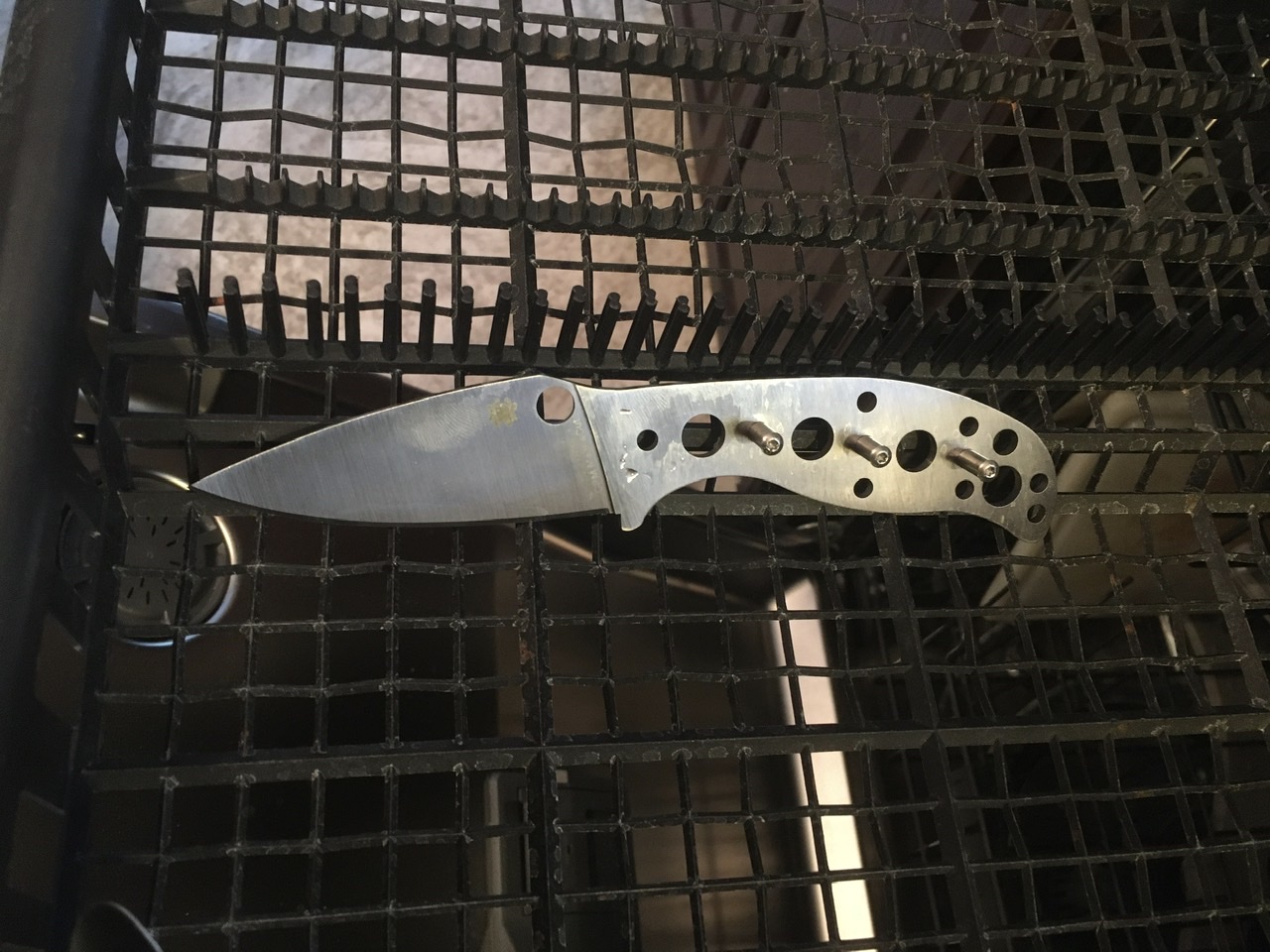

I’m about to do some blasphemy and dishwash my Mule:
