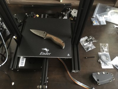

Post by attila »
I finally got my printer set up after months of ownership. I guess I’ll be printing scales soon as well. :)
My B70P helped open the fastener baggies:

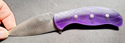

FullScaler
Posts: 273
Re: 3d printed scales with patterns/textures
#66
Post by FullScaler »
A new design from Josh that I printed last night! Perfect timing for this new one since I just got a big order of mounting hardware from USA knifemaker in. Even though I am a Canuck, I am really liking this one.
I am going to run an experiment tonight with white resin, and drip blue dye at the stars end and drip red dye at the stripes end and see if I can come up with a red white and blue version.
Https://BladeProtection.com
Josh Crutchley
Posts: 1426
Location: Michigan
#67
Post by Josh Crutchley »
FullScaler wrote:
Tue Jan 11, 2022 8:50 pm
Looks good! I was just messing around trying to make a 4th of July scale. I started on one with an eagle but never got it done. I probably have more unfinished scales than finished. I'll have to make you one with a Maple leaf.
Posts: 6233
#68
Uber-cool, FullScaler and Josh!
