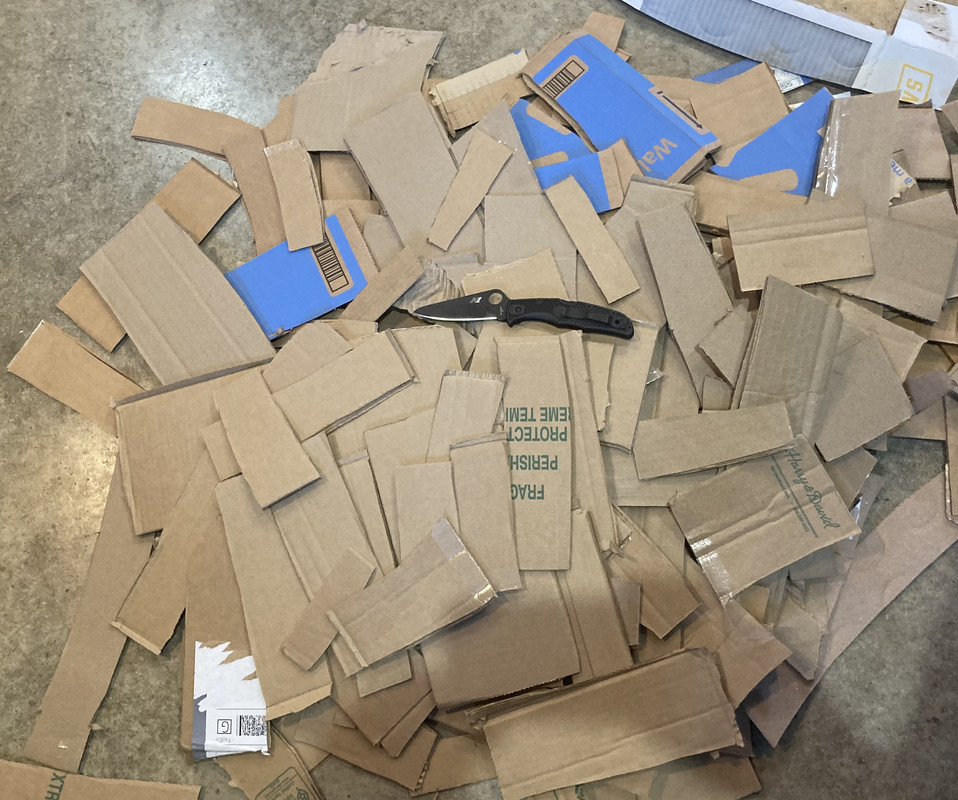

Re: Pacific Salt talk
thinning them out makes a big difference cutting cardboard.
https://youtube.com/watch?v=s4igtwiBK1o
The factory grind isn't the best for certain materials, but when you make the transition from edge bevel to primary grind more acute, they slice very well for a saber grind.
The FFG LC200N version will have an advantage here, but reprofiling the H1 versions bridges the gap to a degree.
I run mine a little thinner these days than it was in the video. No issues with edge damage, and it sees more use than any other folder I own.
Wow, that’s a lot of edc for plain edge h1. Thanks for posting.vivi wrote: ↑Mon Jan 17, 2022 3:13 pmthinning them out makes a big difference cutting cardboard.
