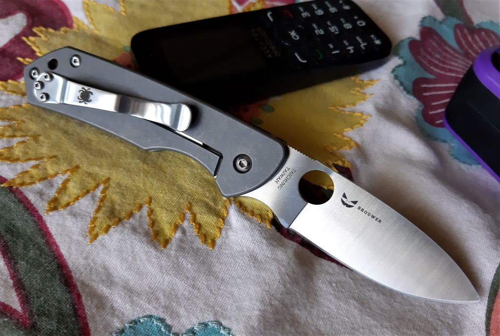

Just got this Brouwer in the mail. I can see why some folks here like it a lot.

Is that an Opus?? Love seeing some of the uncommon models posted!
