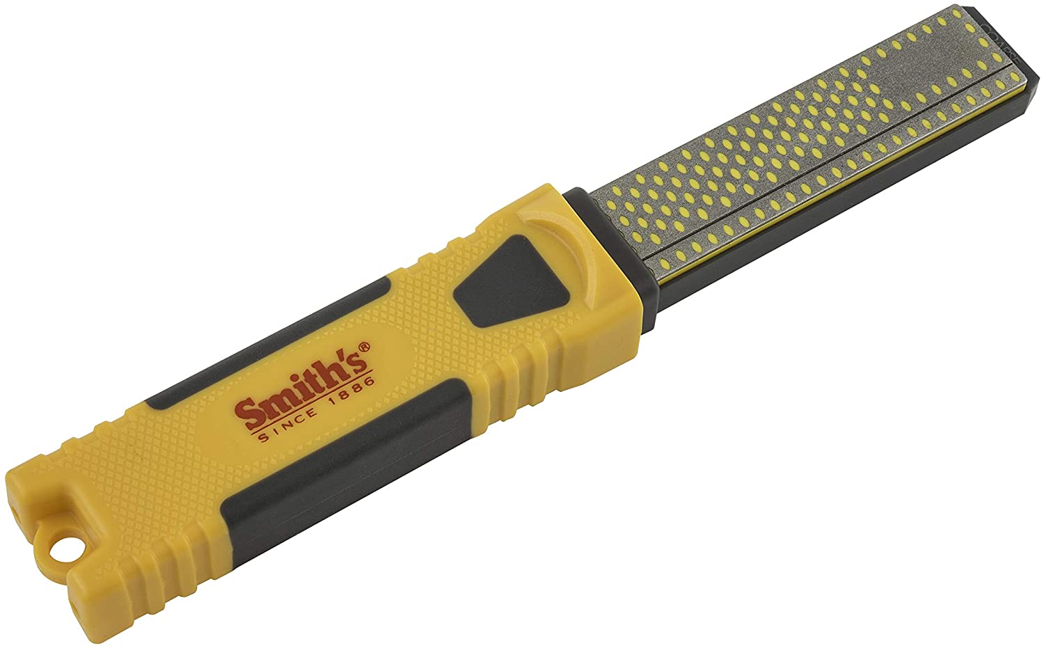

When I first started I used a Smith's double sided 325/750 diamond stone for about $15usd. I like smaller stones, about Edge Pro size is the best for me when it comes to freehand. I learned to sharpen while holding the stone so I never liked wide ones.
I also have the ones Vivi mentioned and was surprised at the quality for the price. The 4 sided thing didn't do it for me so I removed all the plates and epoxied them to separate pieces of flat hardwood.
