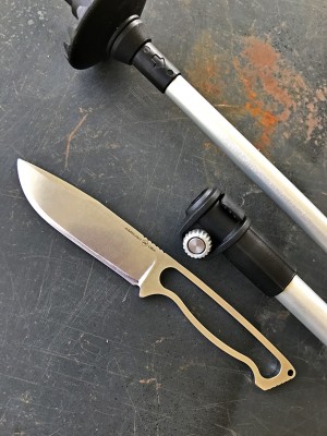

I don't have much to show you guys yet. I've been working on getting the "chonky" blade down to 17 degrees both sides, and that took some doing! See the high bevel in the photo. I was so frustrated with the speed of my diamond stones that I ordered a low bevel rest for my slow speed Coote belt grinder. Next time I have a reprofile job like this, I'm a-grinding it, boys!
It occurred to me today that I could make a handle for this knife that allowed it to slip into my walking poles. That would give me a 4 foot spear! And it would also give me a 4-finger grip. You can see my thinking here...I dunno, just thinking out loud...

Is it really hard to reprofile Elmax with diamond stones?
Posts: 5983
Re: Ambush Sidekick in Elmax
nerdlock wrote:
Tue Jul 13, 2021 6:57 am
I probably overstated my complaint. I don't think it's any more difficult than any other PM steel of its hardness and wear resistance. I was just frustrated that I have a nice machine that could have done the job a lot faster (the Coote belt grinder) but I didn't own the specific attachment that would make the job safe and precise, so had to do the back bevel profiling by hand.
Because of the high saber grind, the blade wobbled on my Edge Pro Apex, so the only other guided system I have is the Lansky, which is what I used. Lansky diamond stones don't seem to last very long.

I agree on the Lansky stones, they seem to dish out quicker than I'd like them to be. I sold my set and got me a Precision adjust. Interested in this blade since it seems like a close analogue to an Elmax Mule. Will be watching your progress in this project.
