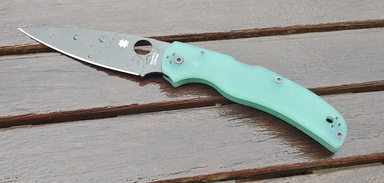

M4 Native Chiefs are arriving today.
This thread is for reporting on fit and finish, sharpness, how they work for you after carrying them etc.
I got multiples today and immediately stuck one in my pocket.
Sharpness is excellent. Entire edge is evenly ground and hair popping sharp.
Pivot is smooth but stiffer than my Rex45's, which is typical when comparing DLC vs satin of the same model.
Fit and finish on this one seems perfect except for one little flaw. The scales are a bit proud of the backspacer. Small enough of a difference I didn't notice when I visually inspected it, but enough I feel it when I reach in my pocket.
I plan to take the scales off to contour and dye them, so I can fix that at the same time.
The G10 feels a touch grippier than my rex45 did when new. I like it.
Really enthusiastic about this combo. I already loved the Chief and I love M4. The DLC blade & hardware with no liners should prove very corrosion resistant for an M4 folder. This will see a ton of carry.

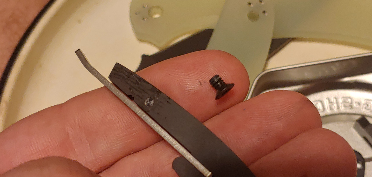

That backspacer/lockbar assembly can shift slightly upon assembly. Try loosening the screws and pushing the bar to align it with the scales. I had to do that on both sprints I have. They’re nice and smoothly even now.

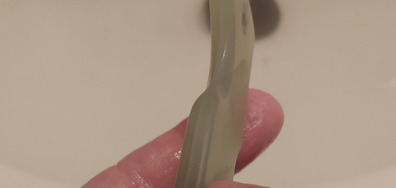

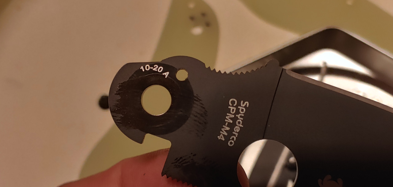

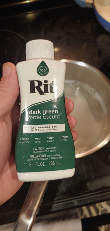

This was so much easier to take apart than the Rex45. Just a small amount of blue loctite, no gobs of white. The stop pin was easy to work free with my hands, the rex required pliers.
I was surprised at how old the blade was.
Got the scales contoured.
Now they're getting dyed.

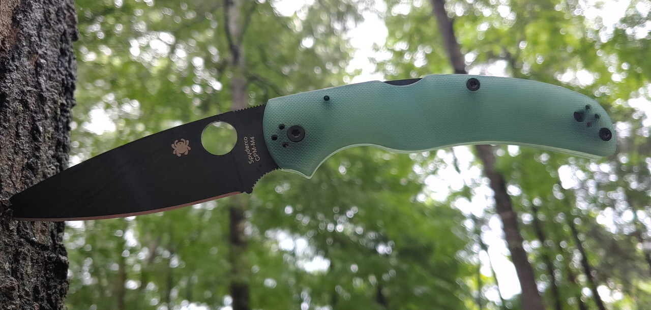

This is one of those knives like the Police 3 that as soon as I saw it I wanted it in my pocket. I love M4, DLC everything for corrosion resistance, the natural scales could be dyed the exact color I wanted, and the Chief may just be Sal's best folder yet.
THIS is the color combo I've been asking for. A nice dark green set of scales paired with DLC tool steel. I think it looks amazing. Couldn't be happier with this Chief.

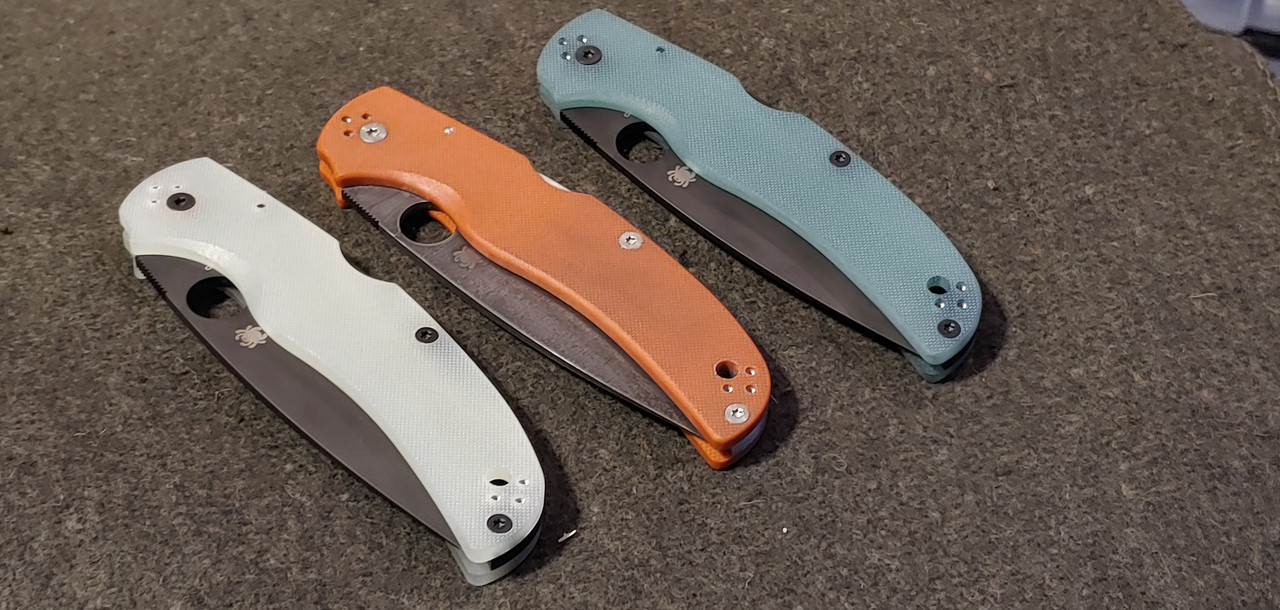

Here it is next to a stock a M4 Chief and the Rex on a few different background colors for comparison:
Tried to shoot a video showing the difference between the contouring on the stock scales and modded scales.

Vivi, that looks great! Of you left it in a little longer, would the scales have turned out darker? I've never used RIT dye, not sure how that all works!
