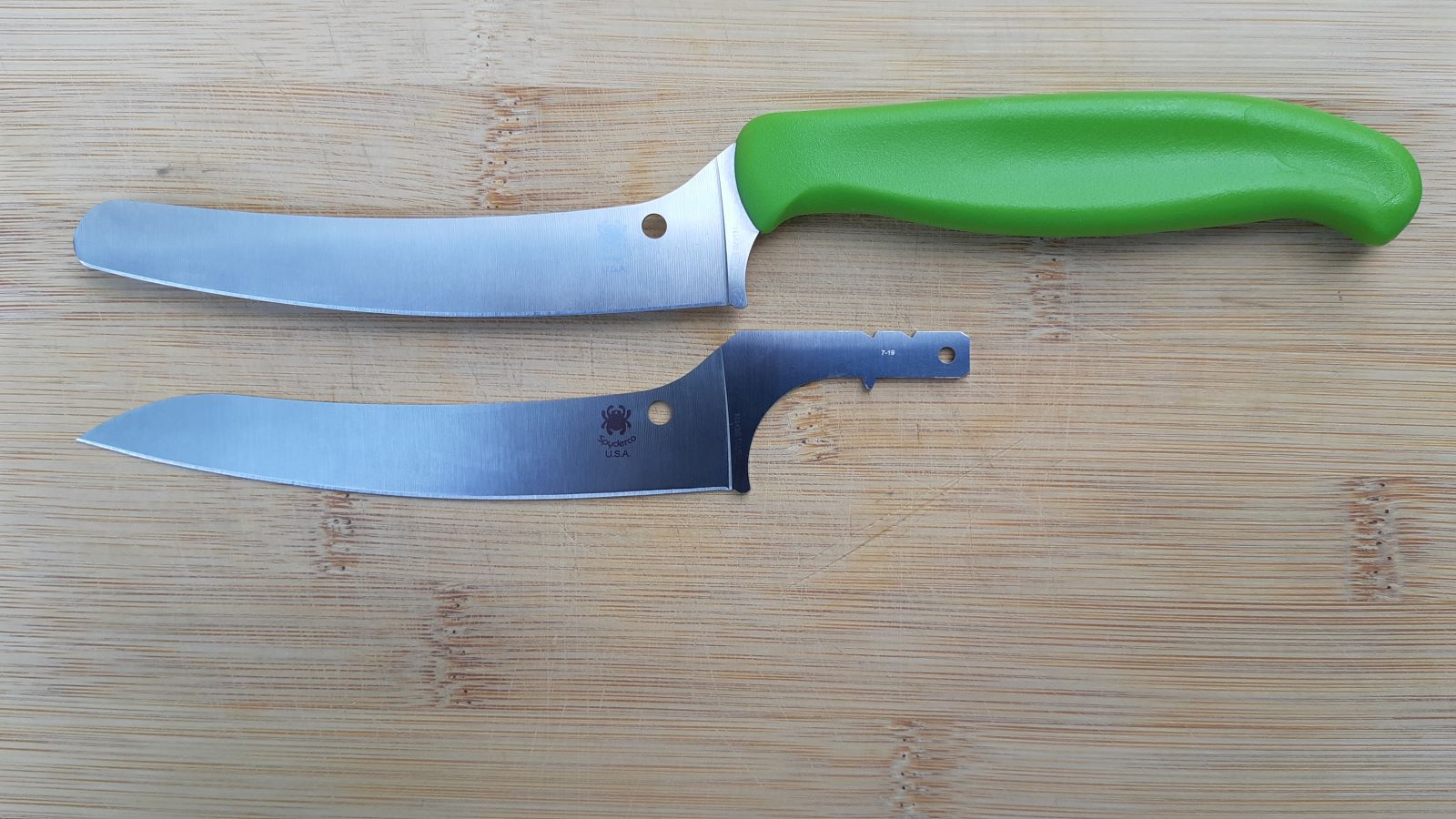

Is it possible that the high temperatures during injection molding of the PP-handle,
which might be around 250 to 270 °C, reduce the mechanical properties and corrosion resistance around the tang area?
If I remember correctly that is what happens if you heat up a hardened blade too much.
At least the tang should see the full temperature of the molten Polypropylen during over-molding.
I have four Z-Cuts. No issues here. Haven't used them for hard cheese, yet.

For the interested folks out there, here how the Z-Cut blade tang looks like.
(I plan on putting on some nicer CF or wood scales, so I removed the original handle.)
There seems to be a date code on the tang like on the Golden folders.
Bill1170
Posts: 3052
Re: Z-Cut breakage
#35
Post by Bill1170 »
Interesting. Based on the photos from Jon and Worm, it appears that Jon’s tang broke at the first stress riser it found, the front edge of the “tooth” that hangs down to lock the tang into the polypropylene handle. I wonder if rounding that transition to the “tooth” would reduce the stress riser there (almost certainly) and weaken the bond to the plastic (unsure). A tooth that looked like a head on a neck like a jigsaw puzzle piece might provide a secure anchorage with less of a stress riser.
Doc Dan
Posts: 16401
Re: Z-Cut breakage
#36
Post by Doc Dan »
JRinFL wrote:
Mon Jun 07, 2021 7:09 am
I'm leaning towards some issue with the batch heat treating of the blades. Some few are getting over hardened.
I think this is the most likely answer.
