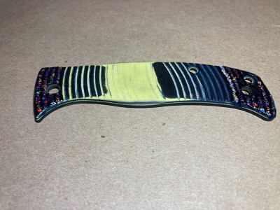

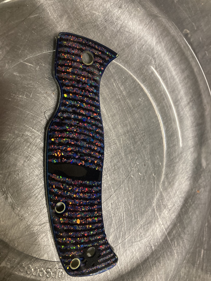

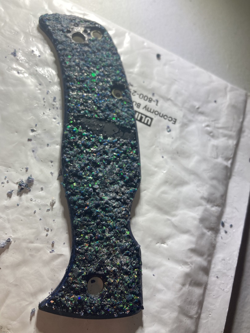

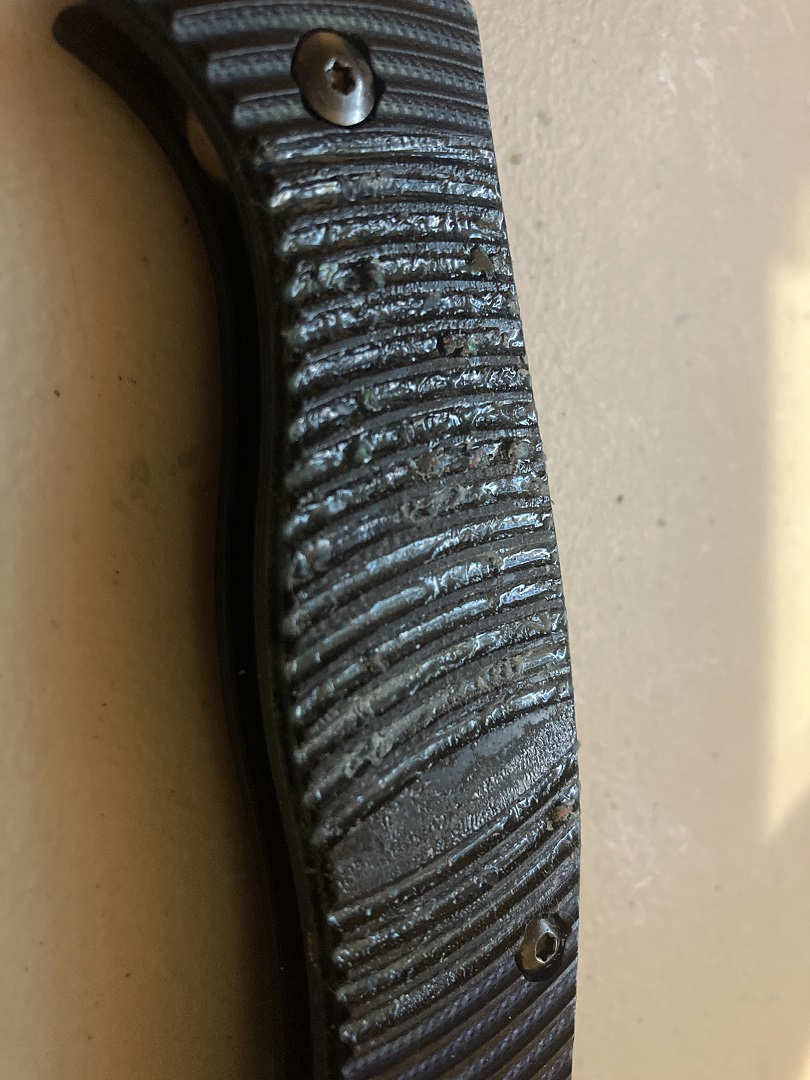

Well I figured I'd share the results thus far after jumping into modding my Caribbean scales....definitely a work in progress and without much reverence to prototyping or R&D--this is definitely a lets wing it and roll with the punches scenario.
First, I thought I'd mix some blue/green pearl, and glow pigment into some epoxy and fill the grooves in the scales and have a cool glow in the dark chameleon look.in the center, and opal inlay at the ends.... It didn't go well and looked like leprechaun poo. so I scraped that out, let it cure and pretty much destroyed scale 1 when sanding it down as patience is a virtue I struggle with sometimes.

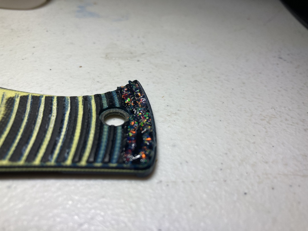

Then I started the inlay on the ends, going with black opal and then a separating band of white opal. I still have the middle to contend with, and I'm trying to figure out what direction to go. I'm considering a carbon inlay, or resin coating it with no pearl and paving the opal into the middle. Trying to figure that out and just ordered some carbon fiber in the event I go that direction. This is how scale 1 sits presently.
After that, I ordered a bunch of opal colors to figure out what design to go with, and with a 2nd Caribbean on hand I could double what I did for each to save the knives, or just keep the 1st one two-faced, we'll see. I was considering the "Eye of Sauron" design last night, but after laying it out I decided not to go with it as I didn't have yellow opal to go immediately around the iris and the tangerine orange didn't come close enough for me. So I decided to use the black opal, and at least it matches the other side of the scale on the ends so there's some continuity in the design. I inlayed the opal, let it cure, and this is what I have after the 1st sanding. I still have to add some more, fill the voids, sand, dye the g10 blue again, then topcoat the whole thing but I'm hoping it doesn't look too bad in the end.
As it sits now, I have the tail ends of the 1st scale in progress with that absolute mess to figure out in the middle, and this second scale coming along ok.
Scale 1 Scale 2 so far today. After sanding it flat and popping in a bowl of water to see what she'll look like. Still need to fill a few spots.

Thanks for the replies guys, I’m hoping I can salvage the first scale. Pokey, I checked out that photo that looks pretty neat and a lot like the scale when the red is flashing.
Salty, I’m not quite out of the woods yet, I have to fix/figure out what to do with the middle section of the 1st scale since the ribs are gone. Right now I’m considering 4 options.
1) carbon fiber inlay cut to the shape of the center section between the opal bands.
2) opal sheet cut to fit same area. There’s 2 styles, 1 is basically like the crush inlay which I can do with the pave method just sprinkling it on and resin coating. 2nd type is “B” cut, cross grain with pretty cool striations.
3) abalone inlay
4) paved crushed opal (sprinkled all over and top coated with resin so it looks like scale #2 but without the black grooves since they’re gone. Either way I have to carefully sand/ remove the rest of the grooved g10 between the opal end inlays.
The 2nd scale was much easier to do once I realized how easy it was sand through the g10 and was careful not to do that.
Which option do you guys would think will look best to finish the 1st scale?
3) abalone inlay

Haven’t had much time to work on these lately. Getting there, just about ready to re-dye the g10 before doing the final fill coats. Trying to determine the best method to ensure I redrill the hardware holes to the right depth. I was considering putting a tiny bit of molding clay in each recess before final coating with epoxy so when I drill it the original hole and depth is retained.
