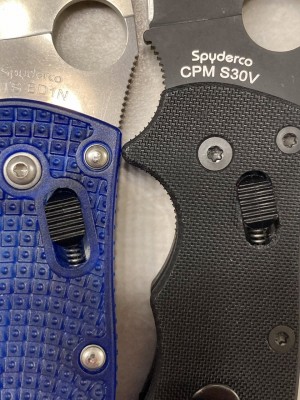

The cbbl on my new cruwear Manix sits significantly lower in the cutout than on my other Manixes when the blade is open. Like the ball bearing isn't seating as far up the tang of the blade as usual. Maybe the spring is shorter or more compressed. Without taking it apart it's tough to see if this would be a problem. There's currently no blade play of any kind, lock up feels solid. Any thoughts?
It was hard to capture on camera, but here's my attempt:

Hmm, that's interesting Julia. I haven't heard or read anything about a CQI on our beloved Manix! Though not a majorly significant difference, it's definitely noticable... especially to those of us that love our Manix's. I just went upstairs and checked my 4 variations and they all look the same as your Rex45 version. I'd think as long as it locks up strong and no play, it should be okay...but that is a little odd. Hoping others with the same knife can chime in or provide pics. I passed on this one myself, but I'm definitely curious.

[EDIT: Julia, I was not really awake already when I posted the now deleted pic (it was early in the morning where I live) - I actually posted the one I took with the blade in the CLOSED position... :o :p
Update it now with the correct one in the OPEN position :) ]
I only have my two lightweights to compare to yours.
I took a pic (now updated in the open position!) so you can check for yourself.
Looks more like on your REX 45 and by that how obviously most (but not all!) Manix CBBLs normally look in the open position, going by the posts so far?!

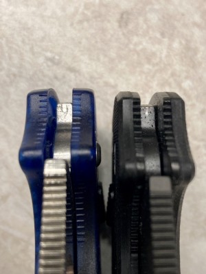

Hey Julia. I would call yours an “early lockup”. I had the same issue after a blade swap. As long as the purple does actually lock, you should be good. It’ll actually allow for more wear on the tang before it bottoms out.
But you should be sure it’s really locking. That was the issue with mine and had to swap back. Basically performed like a really strong slip joint. I know yours isn’t swapped, but here is a pic where you can see the difference in cbbl position:
Notice the gray LW cbbl. Similar to yours. It seemed to lock, but would fold up like a slippie. And the gray g10 was bottomed out and had play. Not sure if this helps, but as long as it’s 100% for sure locking, I would actually be happy with yours because I think the life of the lock will be longer.

Here are my two. It looks like they lock/unlock about the same. I included a photo of the wear on the tang showing how far the bb engages the tang. I can imagine that if when the tang is machined the flat portion where the ball engages is cut just a hair lower or at a slight angle the ball would travel farther or not as far when fully assembled and locked/unlocked. Or, is the hole for the pivot slightly off center raising or lowering the tang? A slight change in the diameter of the bb would make a difference, too.
My point? It could be machining tolerances stacking up one way or the other and making a difference in lock/unlock timing.
That's exactly what I was worried about, PStone, and you're right: "early" does make more sense. Messing with it last night the lock up seemed solid, but I'm going to double check when I'm home later. If it is indeed locking then I won't worry about it. Thank you!
- Julia
Well, turns out the lockup is definitely compromised. I can close it without disengaging the lock. Looks like it'll have to go into spyderco. Sure hope they can fix it!!
