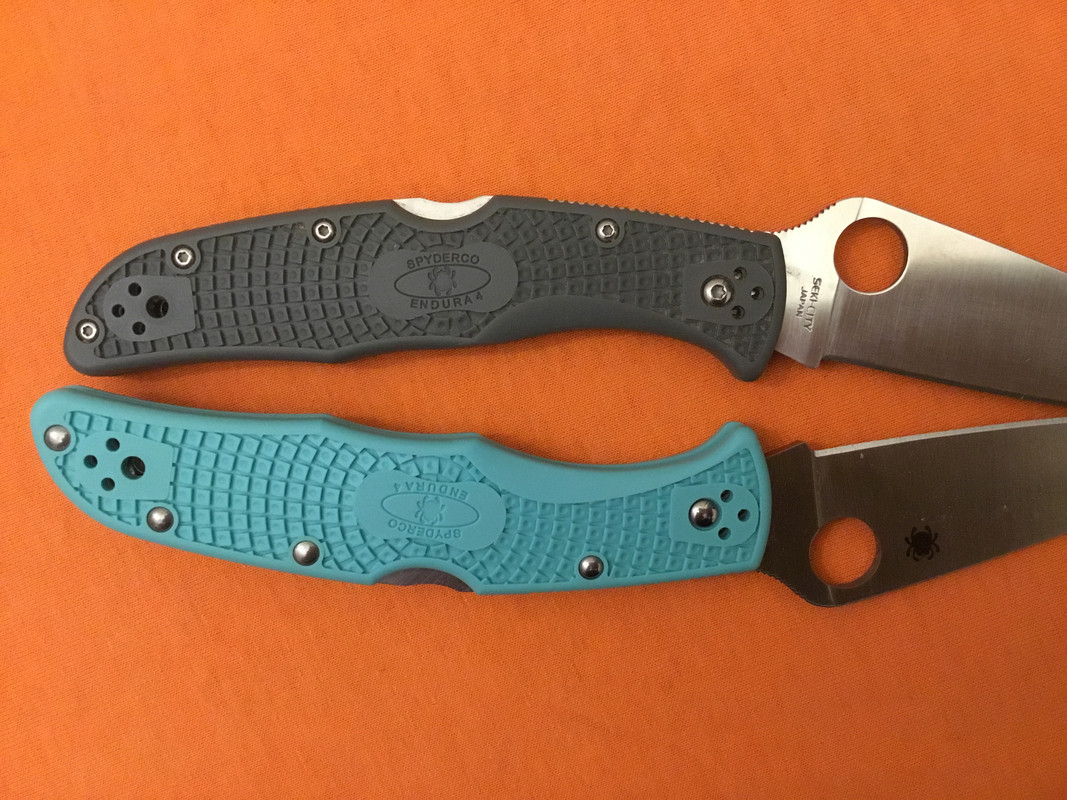

Here is before. The grey had already been done and you can see the difference,

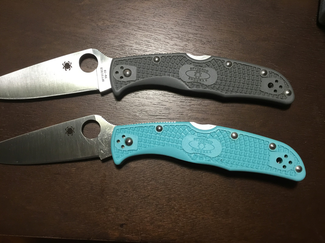

Here is after taking down the first hump.
After the mod there is a flat spot that sits good in the hand.
This modification, though it’s very small, makes a huge difference in the way it feels in my big hand. I took a diamond sharpening stone because that’s what I happen to have at hand and proceeded to file away the part I didn’t want. It was a medium grit. Then I flipped it over to the fine grit and touched it up. It turned out pretty good and it certainly is usable and comfortable. Now I recommend taking the pocket clip off. That way you can tell how it feels in your hand. Go slow take a little bit off and then put it in your hand and see how it feels. Remember you can always take off more but you can’t put more back on.
As a safety note, I wore a mask and I wet the stone with water so that I could minimize that glass dust. I don’t really wanna breathe that in to my lungs and I’m sure you don’t either.

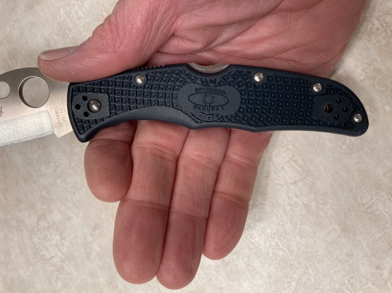

My first two fingers fall into the first groove fine, my ring finger fits in the second groove, but look where my little finger lands. (See the picture below.) My solution would be do the Doc Dan Mod on the 2nd finger groove. (Or the little finger :eek: , paging Doc Dan to the emergency room.)
I think I’ve read here that Sal has said Spyderco is shying away from distinct finger grooves. Until then all we can do is the Doc Dan Mod to make them fit the mitts. ;)
