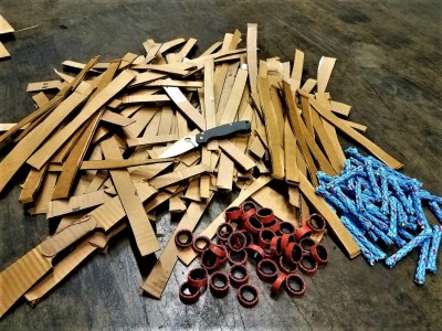

Last week I was carrying my seconds sale Maxamet PM2. The knife showed up pretty sharp, just gave it a little touch up to get to my peak sharpness before carrying it. This knife blazed through EVERYTHING last week and carried on through end of the week tests with no issues at all. I actually ended up cutting over 300ft of cardboard this time around (my coworker was talking to me as I was going through it and I lost track haha) Again, no problem with the internally braided hydraulic hose and not a single slip on the 50 rope cut slices. It then went on to cleanly cut paper as well. A couple snags in that picture are strictly from the tape/grime that was on the blade, not from the edge itself.
Now, granted I'm really not a fan of the PM2, as this gave my thumb the same nasty blister as the S30V model I did a while back...but, I bought this knife for a cheap opportunity at Maxamet. This steel certainly didn't disappoint! It's funny, mine is a seconds because of a slight warp in the blade and it definitely trailed off a couple times on the cardboard slices because of the warp haha. Not a problem with just regular cutting though.
It's impossible for me, preferring the high edge retention to not rank Maxamet at the top with Rex45 and 4V. Had this been on a Manix or Shaman...OH BABY!!! But, after a weeks worth of use and granted it's been a while since I've done this, I have a hard time ranking it as #1 on its own. That's not because of performance, but because of the typical price of a knife in Maxamet. Do I think if I were to carry and use it until completely dull, would it outlast Rex45 and 4V?? Sure, I believe it would. But, I never let my knives get completely dull and certainly wouldn't want to do so with this beast of a steel.
After a week of carry and nonstop use, I think I would still VALUE Rex45 or 4V more just because knives in those steels are quite a bit cheaper than a knife in Maxamet in MY opinion. I'm glad I got this knife though and look forward to continue using it and playing around with this steel!

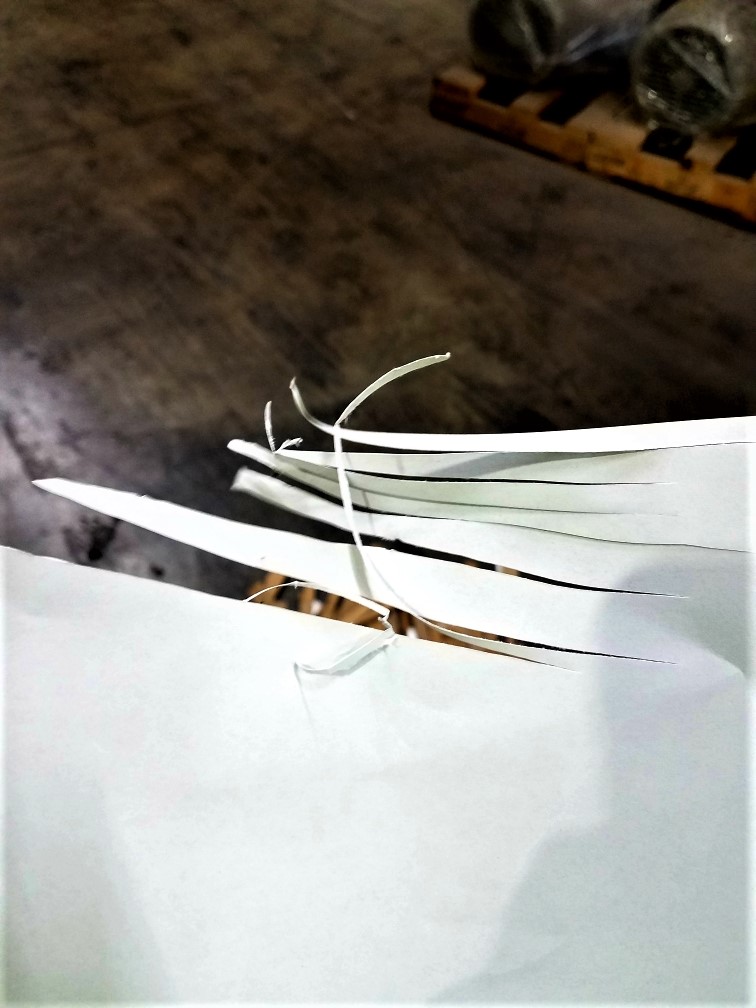

I'll play, still super happy with the performance of my K390 Endela. Fist day I got it, I tested the edge on paper as a point of reference, then proceeded to cut up the carboard that my new 8"x12" shed was packaged in. Cut up, it filled a 96 gallon container. Afterward, the front half of the blade will cleanly slice paper while the rear half would still slice but there were a few sticky spots. About 6 passes per side, alternating, on the brown sharpmaker rods, and the entire blade was cleanly slicing through paper again. I love how long the blade remains sharp and perhaps more I love how easy it is to maintain that edge. About once a week I give about half a dozen passes per side on the white rods and it stays razor sharp.
