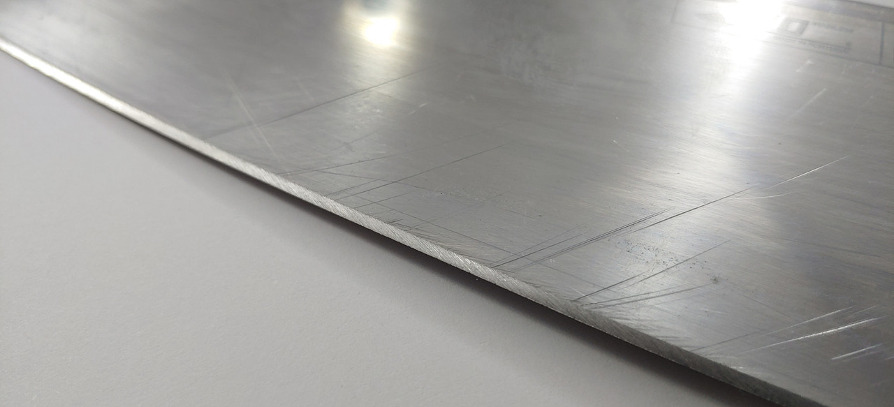

So I decided I wanted to thin out this machete a bit and repair some pretty bad edge damage. Still needs a little work, but it was also more of a trial for me with free hand sharpening. I've done it before but scratched up the blade a bit, so I figured with this being beat up already it wouldn't really matter and is good for practice.
I was using my DMT Diasharp stone that has an extra coarse and coarse side to the stone. So far so good, even on the recurve portion of the blade. I can feel a nice edge beginning on a good portion of the blade. I find using the Michael Christy method of sharpening free handed, at least on this softer steel, seems to be working well for me so far.

That edge is looking good! Nice and even.TkoK83Spy wrote: ↑Mon Oct 26, 2020 6:57 amSo I decided I wanted to thin out this machete a bit and repair some pretty bad edge damage. Still needs a little work, but it was also more of a trial for me with free hand sharpening. I've done it before but scratched up the blade a bit, so I figured with this being beat up already it wouldn't really matter and is good for practice.

Yep! That's what I've impressed myself with so far, is how even it's looking. Gives me some confidence to free hand my 52100 Manix to something around 15-17 degrees. I keep reading how that steels performs better at lower angles, plus that knife isn't the most even on both sides as it is.bbturbodad wrote: ↑Mon Oct 26, 2020 11:40 amThat edge is looking good! Nice and even.TkoK83Spy wrote: ↑Mon Oct 26, 2020 6:57 amSo I decided I wanted to thin out this machete a bit and repair some pretty bad edge damage. Still needs a little work, but it was also more of a trial for me with free hand sharpening. I've done it before but scratched up the blade a bit, so I figured with this being beat up already it wouldn't really matter and is good for practice.

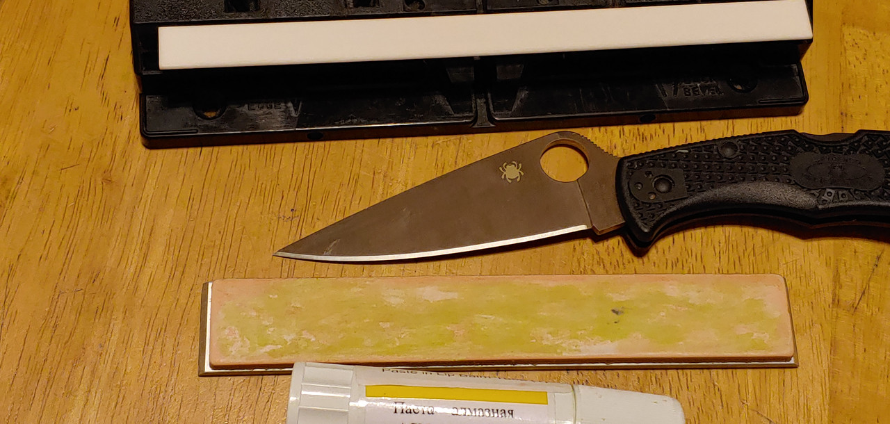

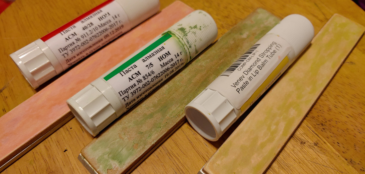

Got to try out some new compounds today.
Red = 40 micron
Green = 7 micron
Yellow = 1 micron
Really big fan of the 40 micron red. I think I will be using that to maintain my EDC between sharpenings on my 300 grit plate.
https://www.gritomatic.com/products/cow ... 3d7e&_ss=r - This is the strop I use. If you search for Venev you'll see the compounds.

I really wish I could understand this stropping compound stuff, I'm honestly totally clueless. Heck, I don't think I even maintain or properly use my KnivesPlus strop as it is. Sometimes I feel I actually lose my edge, even with a couple light passes. Very frustrating.
Re: Community Sharpening Journal
I felt that way before. There's a few things that helped me.TkoK83Spy wrote: ↑Wed Oct 28, 2020 8:54 pmI really wish I could understand this stropping compound stuff, I'm honestly totally clueless. Heck, I don't think I even maintain or properly use my KnivesPlus strop as it is. Sometimes I feel I actually lose my edge, even with a couple light passes. Very frustrating.
- Using a lighter touch
- Switching from regular buffing compound to diamond based compound
- Getting new strops
I don't know anything about maintaining strops. All I've ever done to my strops was rub more compound in them before each use.

I like wood strops with CBN compounds. Load them up and reapply compound as needed until they get dark from steel. When they need to be refreshed I sand them down and start over. I also use fine stones (7 -2 micron range) with light stropping passes to maintain edges between sharpenings.vivi wrote: ↑Wed Oct 28, 2020 9:01 pmI felt that way before. There's a few things that helped me.TkoK83Spy wrote: ↑Wed Oct 28, 2020 8:54 pmI really wish I could understand this stropping compound stuff, I'm honestly totally clueless. Heck, I don't think I even maintain or properly use my KnivesPlus strop as it is. Sometimes I feel I actually lose my edge, even with a couple light passes. Very frustrating.
Wow 40 micron compound...that's like a Venev 240 grit stone!

I've got a pack of square wood sticks I experimented with as strops, but never seemed to get the same results as leather.bbturbodad wrote: ↑Wed Oct 28, 2020 10:51 pmI like wood strops with CBN compounds. Load them up and reapply compound as needed until they get dark from steel. When they need to be refreshed I sand them down and start over. I also use fine stones (7 -2 micron range) with light stropping passes to maintain edges between sharpenings.vivi wrote: ↑Wed Oct 28, 2020 9:01 pmI felt that way before. There's a few things that helped me.TkoK83Spy wrote: ↑Wed Oct 28, 2020 8:54 pmI really wish I could understand this stropping compound stuff, I'm honestly totally clueless. Heck, I don't think I even maintain or properly use my KnivesPlus strop as it is. Sometimes I feel I actually lose my edge, even with a couple light passes. Very frustrating.
That 40 micron compound is awesome. Works much faster than any other strop I've tried and leaves an edge that really grabs at my fingerprints.

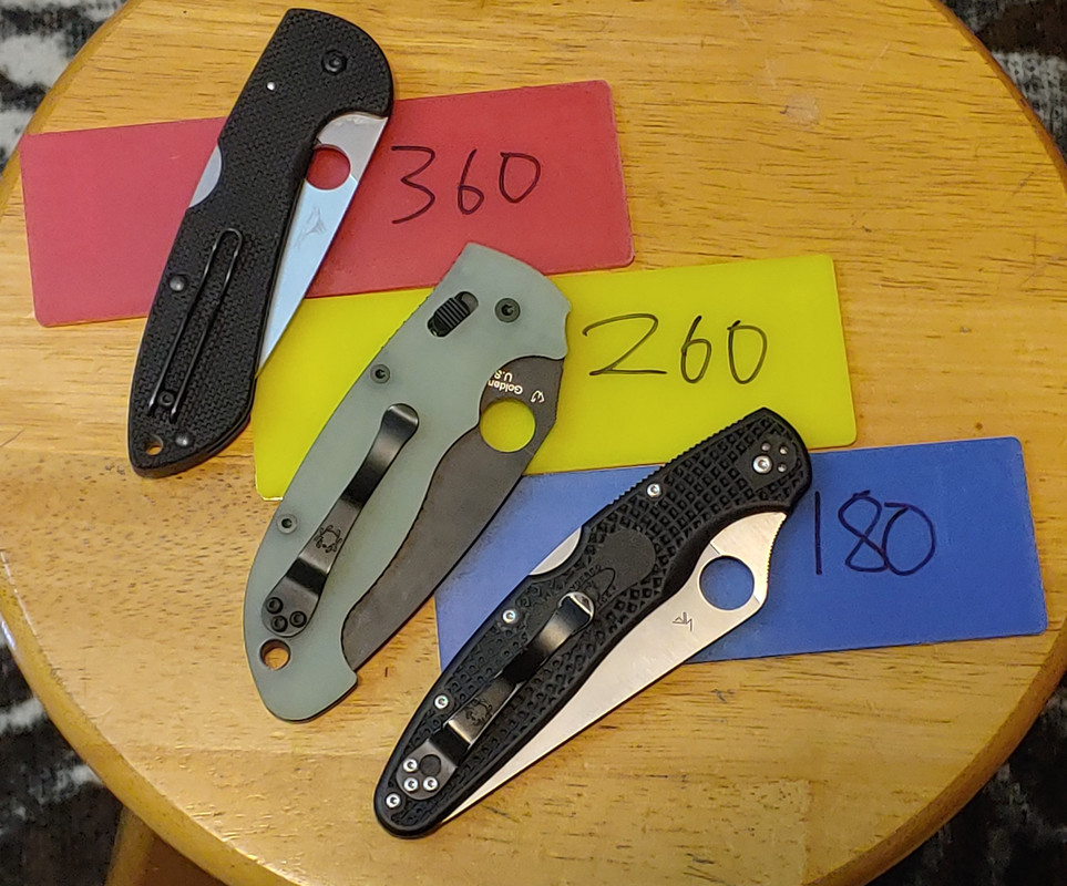

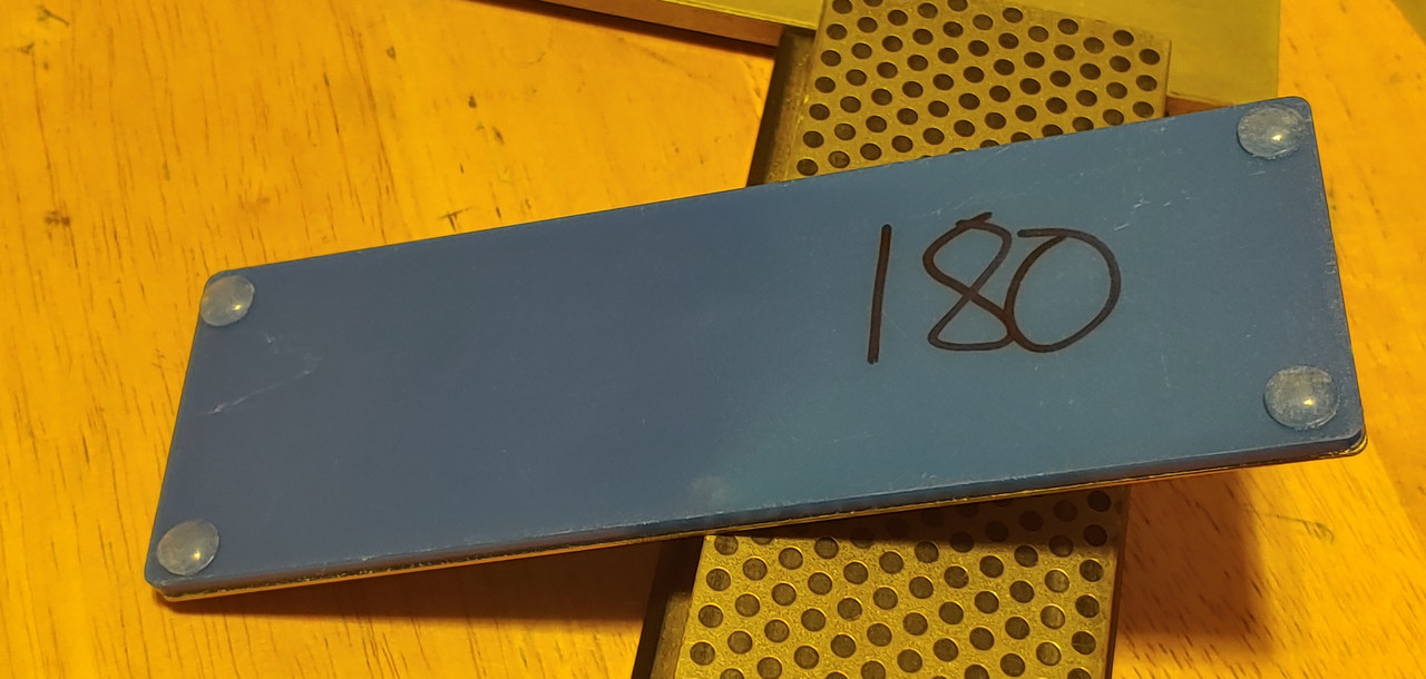

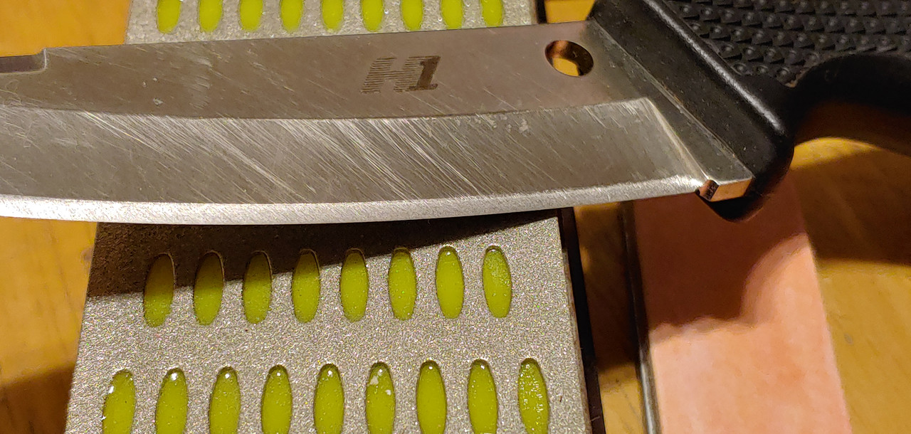

So a while ago I tried these diamond plates from Harbor Freight out. Wasn't impressed. Didn't get good edges off of them holding them in my left hand and the knife in my right.
Today I decided to add some rubber feet to the bottom and try the 180 grit again. Reset the bevel on my chef knife I use at work. Here's a photo of the edge straight off the stone:
Very coarse edge. This stone reprofiles faster than any stone I've tried, second only to my powered equipment.
Despite the large crusty burr visible in that picture the knife could scrape shave right off this stone
I followed up with 5 passes per side on the sharpmaker at 15 degrees with brown rods, then finished with 3 passes per side on a 7 micrin diamond compound loaded strop.
I can run my nail down the edge and it feels very coarse, like its fresh off the 180 grit stone, but it sends arm hairs flying with a light touch. Excited to take it in to work tomorrow. It should push cut with ease, and once I've dulled it some it should still slice ripe tomatoes easily with the toothiness left on the apex.

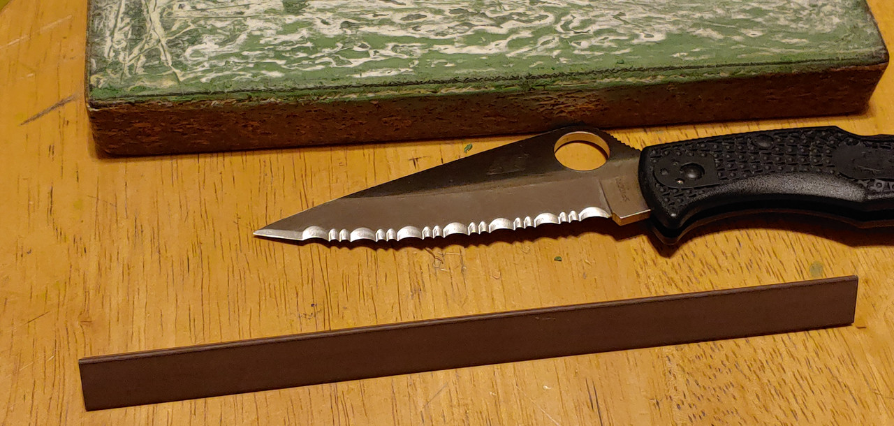

Next up, my LC200N Pacific Salt.
Dulled it a bit at work and gave it a quick touch up. Four passes per side on a never been used fine sharpmaker rod setup free hand, then three passes per side on a 1 micron diamond paste strop. Very, very sharp. I plan to run polished edges on this knife until I get around to reprofiling it just to experience different finishes on LC200N.

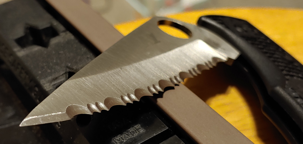

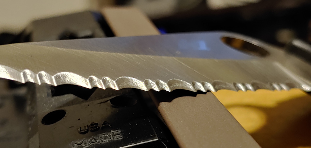

Followed by my SE H1 Pacific 2.
Ground it on the brown sharpmaker rods at 20 degrees on the presentation side until I raised a burr. Worked it back and forth from that point until I had a crisp apex. Stropped on the corner of a leather strop with 7 micron paste. The PE tip pops hairs and the rest feels much sharper.

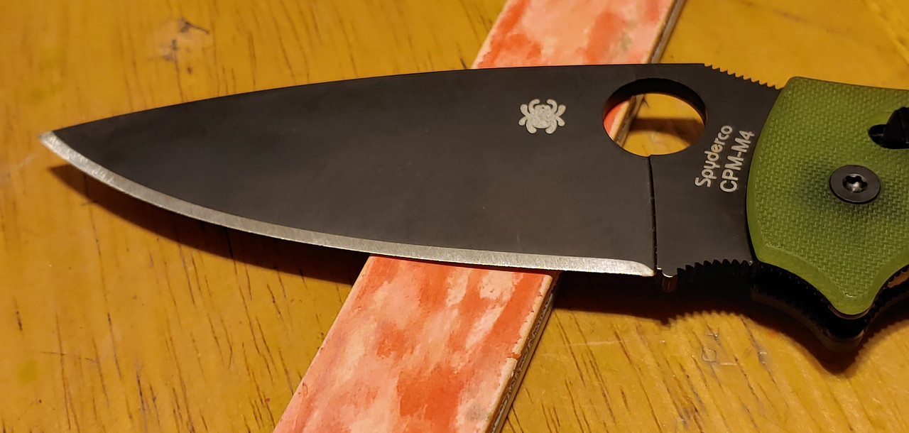

Wasn't shaving but was still pretty sharp. All I did was strop it four times per side with my 40 micron strop.
I've been using this for touch-ups on my M4 Manix and I really like the results. The edge I get is much, much more aggressive than with any other strop I've used. Really big fan of how this coarse diamond paste works for touch-ups.

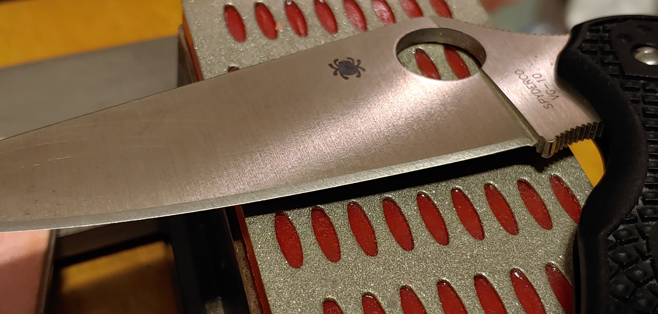

Police 4 LW VG10:
Reset the edge on my 360 grit diamond plate, then did 2x strokes per side at a slightly more obtuse angle. Finished with 3 passes per side on the 40 micron strop.

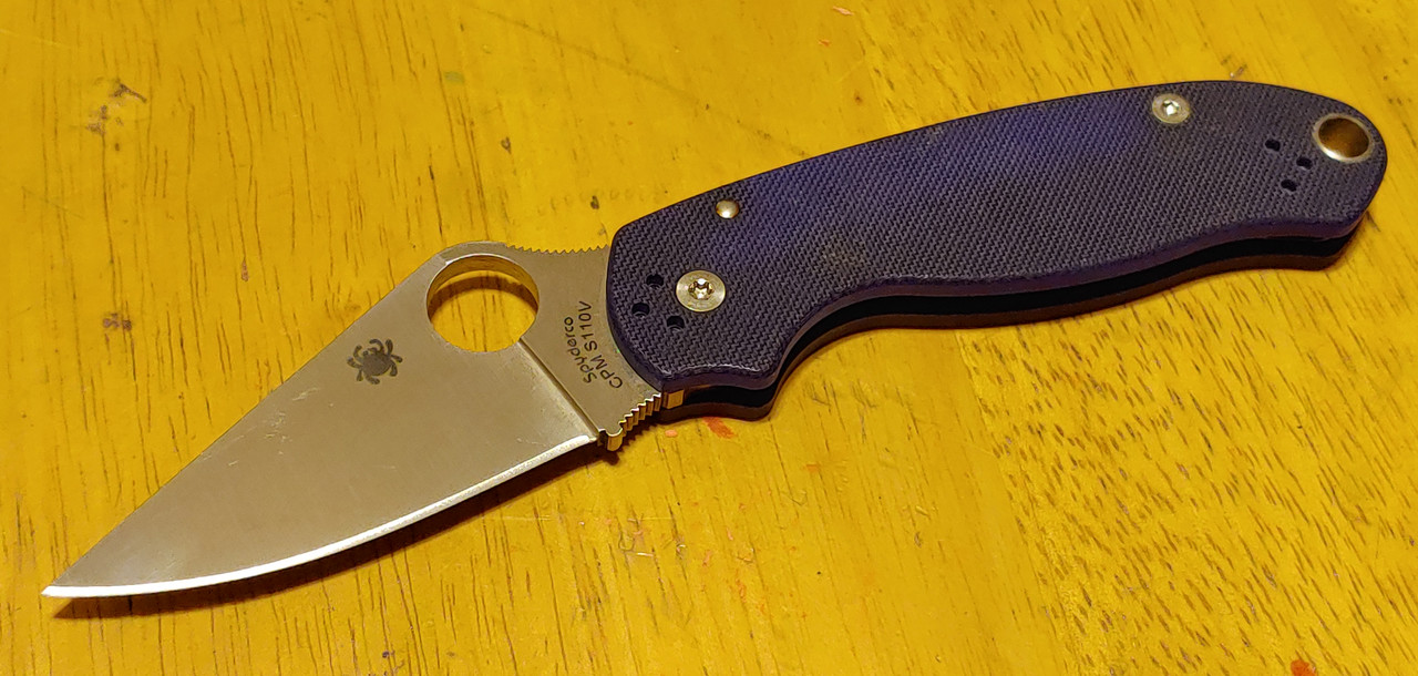

One of the nice things about my job is I really get to appreciate a fine sharpening job. My chef knife was nearly push cutting ripe tomatoes with the weight of the blade alone. Yesterday it was so dull I had to initiate cuts in them with the tip, today they barely offered any resistance to the blade.

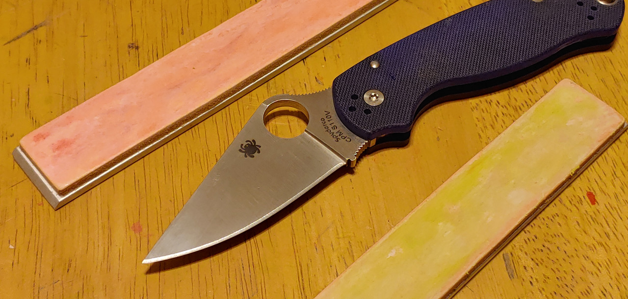

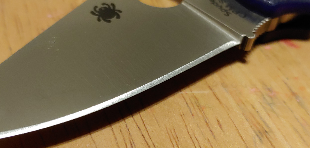

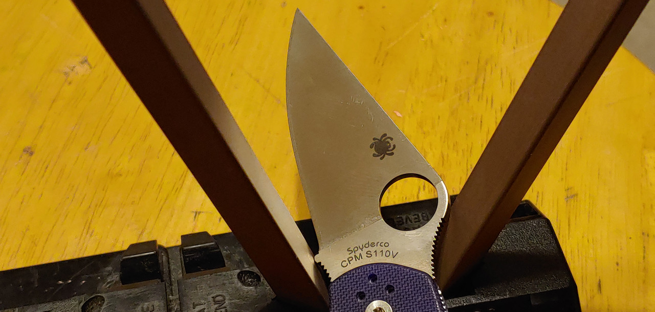

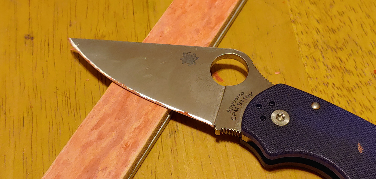

First thing I did after work was finish that S110V Para 3. I kept putting it off because I wanted to make a cutting demo video with it, but I couldn't find the time.
Here's the step by step process I used.
Step 1 - Set the bevel at around 12-14 degrees per side with my 180 grit stone. I left the edge a bit thicker than I would personally run a Para 3 since I'm not sure how the owner plans to use it, and I'm not sure how thin S110V can be pushed.
Step 2 - Once the bevel looked pretty even and I was raising a burr on either side, I switched to single strokes per side, stopping to check for a burr between every pass. I tried to minimize the burr as much as possible on the 180 grit stone. The Para 3 readily shaved, not quite hair popping sharp but easily scraping off stubble.
Step 3 - Using freshly cleaned medium sharpmaker rods I applied a 15 degree per side microbevel. I used 4 strokes per side, trying to refine the edge without polishing off the teeth from the coarse diamond stone. I thought 4 strokes per side would work well with how wear resistant S110V is, but the result was an edge that was more polished than I was going for. It's nice and sharp, but running my nail down the length of the edge it isn't as coarse as I intended. I decide to carry on.
Step 4 - I stropped 4 times per side on a 40 micron strop.
Step 5 - I stropped 4 times per side on a 1 micron strop.
After that I cleaned up the scales, scrubbed a bit of the rust off the pivot pin, and oiled the pivot. I'll contact the owner and see if they're ok with this edge or if they want me to refinish the apex to something coarser.
