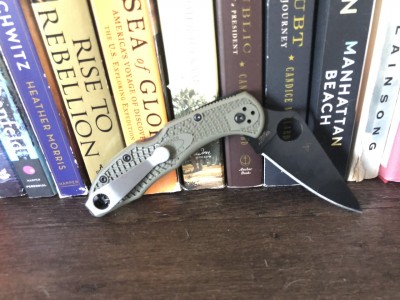

First CRUWEAR knife I have owned, don’t know a ton about it. How does it stack up with S30V? This came from DLT, lighting fast. At the suggestion of a forum member I scooped it up and am very glad I did.

My understanding is it's one of the most well rounded steels out there. It'll be more ductile, tougher, and hold an edge longer, than s30v.

I find edge retention to be on par with S30V, corrosion resistance to be just slightly lower than S30V and toughness to be much higher than S30V.
I like Cruwear for its balance of qualities as well as it’s ease of sharpening and it’s ability to handle accidental contact with hard objects like stone or metal.

Awesome - DLT is so fast! I also like cruwear quite a bit: tougher than s30v but just as easy to sharpen. If you've ever had a fixed blade in 3v, this is a step up in edge retention from that. It does seem that edge retention varies a bit depending on how hard spyderco runs it - most of their Cruwear has been 62-63rc it seems, but the Shaman last year was run softer at closer to 60rc. I'll be interested to see if anyone tests the hardness on these blades.

I'm slowly re-buying all of my favorite Spyderco's in Cruwear as they become available. Toughness is important to me as I have a tendency to use knives in ways they weren't always designed to be used... (don't tell anyone) Very tough steel, and though it is considered to be "semi-stainless" I haven't had any of my 4 Cruwear knives show any corrosion so far, and it sharpens great. My DLT Delica like yours is "out for delivery" now....

Wait till you sharpen it, that’s when you’ll really get a feel for it & fall in love. Amazing feedback on the stones. They don’t call it “a sharpener’s steel” for nothing. It gets scary sharp, very easy.
And it’s tough as ****.
