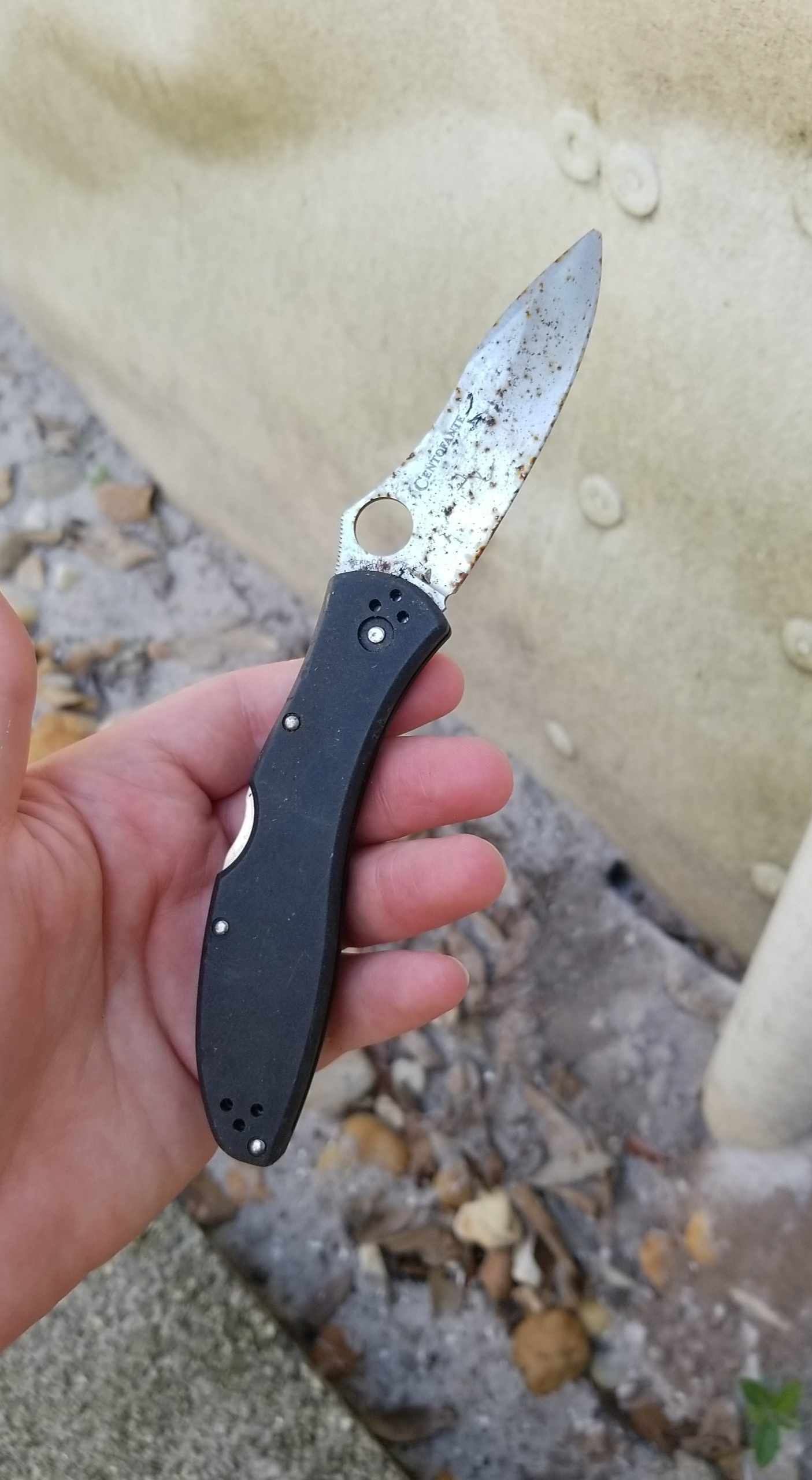

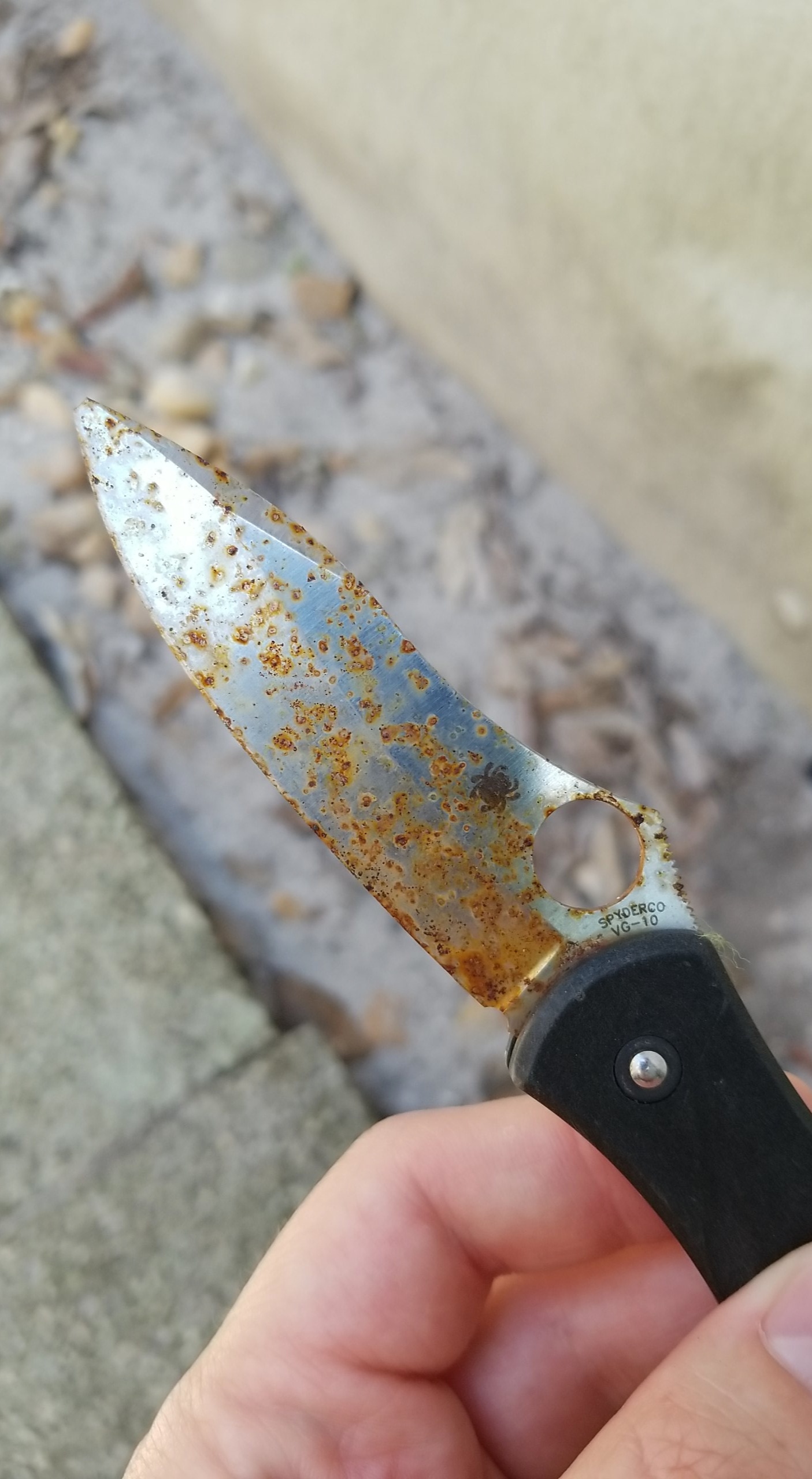

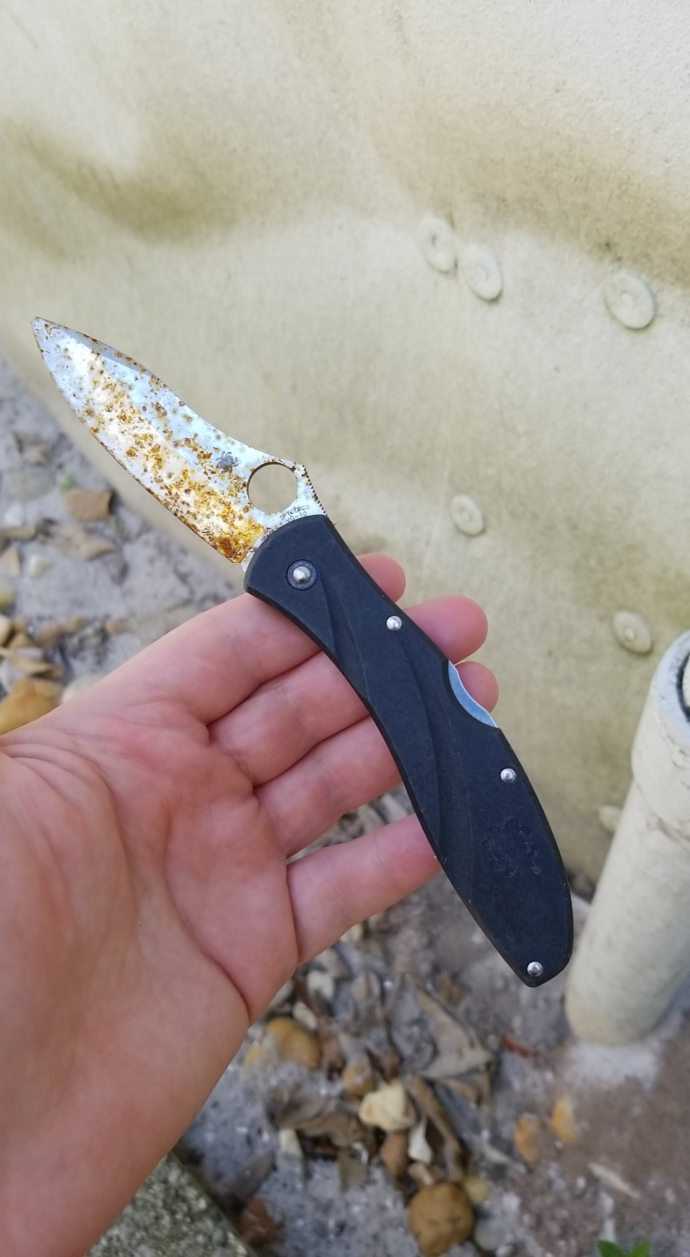

Found this one on the side of the road this morning 😯
think theres hope for it?
I wish it wasnt pinned together as the liners are rusted a little as well.
I'm going to try and clean it out with air compressor, and use some scotch bright for the rust..,
any suggestions?
Tbh I have never really looked much at the Centofante but the ergos feel great in hand.
Can I send it in for a spa treatment 😂

You can send it to us, but I don't know how much we can do depending on how deep the pitting goes.

It might be permanently pitted but you can clean off the rust and sharpen it up and bring it back into the fight. Too bad it's a pinned pivot.

Soak in wd-40 and clean with a cloth. Then rub in places with an eraser.

It's got "character." Besides, the FRN looks great! ;) Rub it with a pre-1982 copper penny. That will remove the red rust; the pitting is permanent, though.

Knives like that end up having 1000 lives. As long as the pivot isn't rusted solid, it just needs some cleaning up. Show us some photos after you work on it a bit. Even if there is rust in the pivot, I'll bet some CLP or Kano Kroil or penetrating oil of your choice and some exercise will get it going again. Congratulations on the find.

Cool find. I’d wash it in a basin of warm, soapy water then flush it with oil after it’s dry.
Then a progression of wet and dry sandpaper to clean the rust off (say 800,1200,1500,2000 grit) and resharpen and you’re good to go.
