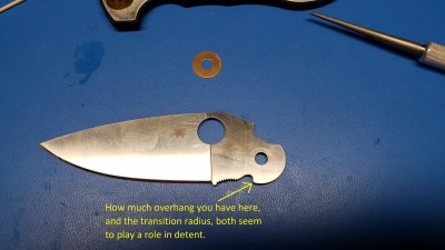

And yes, despite (as explained in my previous post) I strongly prefer the CBBL for various reasons, the Axxis lock is easier (too easy for me...) to operate. Might be an advantage for people with really weak fingers, maybe due to an illness, surgery or whatever (or admittedly just cause differently to me, they prefer the feel of the axxis lock). What still remains is its in my experience weaker detent and more fragile spring.
It just comes down to taste in the end. As far as the detent goes, it's really a function of two things as far as I could tell. The first is spring strength, mine are a little stiffer then a standard 'omega' but not by much. The second is how you grind the detent in the blade(see picture). I was shooting for somewhere in the middle of Axis and CBBL. I had to re-grind this area anyway to get the blade to fully close. The detent actually turned out right about how I wanted it, and I can always tweak it a little if I want.

That's badass! So...what's the secret to homemade Omega Springs? I've tried, and just cant get them to form and work?

Matt David wrote: ↑Mon May 04, 2020 5:02 pmWartstein wrote: ↑Mon May 04, 2020 8:01 am
Thanks a lot for the insight! Obviously you know a lot more about this than I do. All my personal experience with the Axxis lock admittedly comes from one single Minigrip.
An Axxis lock tweaked towards stronger detent (and with more durable springs) would be a vast improvement imho. But then, since the CBBL already gives me that (functionally, I know it is technically different) and even in Spydercos, I am happy anyway...
