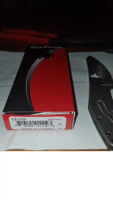

I'll get the UPC/ date code picture tomorrow. The rest of the knife held up beautifully, clip, titanium, hardware... awesome!

Here's the UPC on the box, I'm not sure what to look for? Can someone decode this?

Correct me if I'm wrong anyone, but that appears to be new stock - 'IS' is September '19 production if I'm not mistaken?
I'm no expert on the Spydiechef, but the most recent run would have a ceramic bearing as Sal said. Your knife has the new black hardware as well.
As a few people have mentioned, it's quite possible that those rust spots are just from surface contamination of minute particles of non stainless steel. The area around the ceramic ball detent may be tooling residue.
Have you tried cleaning it with some polishing paste? If you don't have any, try some toothpaste and an old toothbrush. ;)
If it comes off clean, take it in the sea or immerse it in water again. My Waterway was absolutely fine after cleaning those specks off, as mentioned above.

Sharkfisher51 the letters on the right side of the box are the date code. The first letter is the month and second letter is the year. The S indicates your knife was made in 2019. So you have a cqi version which should have a ceramic detent ball. We sort of assumed you did but just wanted to make sure you didnt get an old one somehow. There are some unlikely possibilities, but its more than likely that what pretty much everyone on here has been saying is whats going on with your knife. And thats that it has contamination from the factory during the assembly process. And the solution remains the same. Clean it and continue to use it. It is very unlikely to have this problem again if completely cleaned. I may even suggest disassembling and cleaning it but that is at your discretion.
