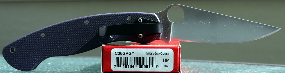

Post by toxophilus »
Only noticed this on my M390 Military; as others have stated it's no biggie, I either tighten it or a dab of loctite. The pivot screw isn't going anywhere as I'm using an MXGear aftermarket DCPC on this one (similar to the one on my Cruwear Military) :spyder:
