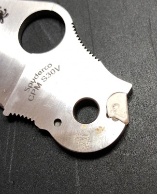

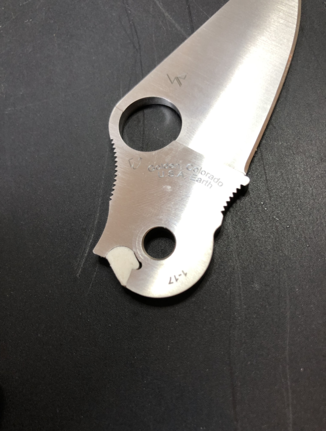

I would like to show you a mod i‘ve done to my Para 3.
But first of all... WHY?
I live in Germany (so sorry for my english) and the knive laws here doesn‘t allow to carry knives which can be opened one handed and locked. You must choose between one handed opening or locking. Both is not allowed.
I got a few Spydercos, also some (legal) Slipjoints, but the Para 3 is far my favorite knife.
This is why i wanted to use it as a legal edc in Germany.
I developed a part that converts the compression lock into a slipjoint. The slipjoint is not as solid as the one on a Ukpk but stable enough for daily tasks.
This part is just a prototype out of my 3D Printer but already works very good like you can see and hear in the video.
Next step will be to mill it on a cnc out of metal.
Or maybe spyderco itself could offer such a part? :D
https://youtu.be/m390dajDBpc
Any feedback is welcome :)
Cheers Dirk

Well done dirk. Looks like it’s doing it’s job.
Wonder how you could get a half stop in there. Probably have to notch the blade or something.
Welcome to the forum.

Thank you all for your positive feedback. I will try to answer some questions and lack of clarity.
@sal I will check how I can send you one of these parts. I never send something to the USA before. Do you have access to a 3d printer? I could also send you the 3d model. So you can print or mill it.
@SF Native There is no half stop. But you could add one with a small hole at the same radius like the other holes.
@Warstein Yes, the mod only disables (changes) the locking. This is no permanent mod and can be easily reversed. But it can only be removed when you open the knife. Removing the mod within seconds or without opening the knife would it make illegal.
@TomAiello It installs very easy. You just press it into the blade. It will be "locked" in place because of its shape. To remove it you just open the knife and pop it out of the blade.
@Marulaghost You can travel with such a knife. These knifes are not complete prohibited, it is just not allowed to carry it so that you can use it quickly. (You can also carry it in person under special circumstances. But it is really(!) complicated.)
If you put your Para3 in the lower part of your closed backpack or another sealed case it is also ok. But to be safe, you should use a knife wich can be opened one handed and doesn't lock OR a knife which locks but can't be opened one handed.

Nice work! I like it for the obvious reason, but also that any wear to the little plastic part can be remedied by replacing it!
