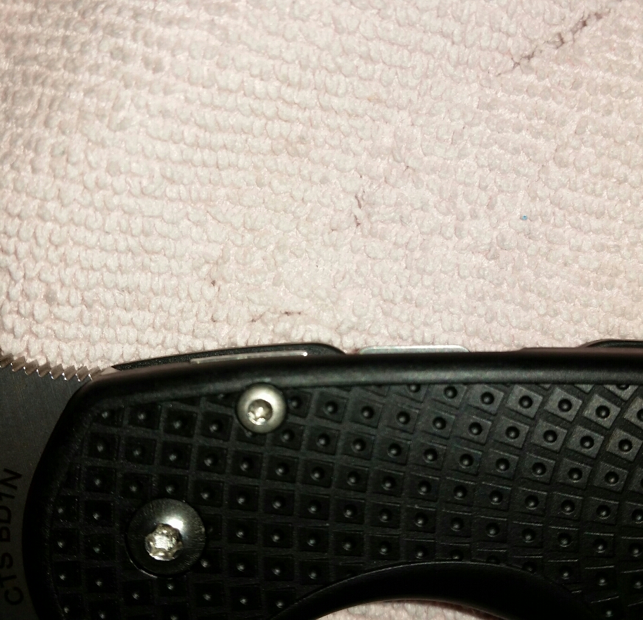

Had the Para 3 LW PE in my pocket the last two days!
Our sample OOTB had the pivot cranked tight (couldn’t snap flick it closed using compression lock) and the blade 10-15% off center. The edge was hair whittling sharp with somewhat straight bevels ....not the large deep uneven grind towards the tip on one side... like some recent dealer exclusives! I disassembled the knife (took 5 minutes ) using three different Torx :T6 for stop pin screws, T8 for body screws, and T10 for the pivot. Not heavily caked with thread lock...very easy to get everything stripped down COMPLETELY!
I used 400 grit to sand the inside edges of the FRN scales as they were a little sharp, Very easy mod that took 2 minutes . Knife went back together very easily and has 75% of the action of the normal G10 Para 3. The knife slow rolls , Thumb /spidie flicks, and spydie drops with no issues. Getting the blade so there's no play makes closing the knife with the the "normal" compression lock wrist snap in more challenging. You can see that condition in most of the YouTube videos...especially GP knives.
That's the nature of the build with this knife and doesn't hurt its performance whatsoever as far as I can tell. The P3LW goes into my pocket with no problems and the clip seems to have decent retention. If your expectations are for a cheaper FRN knife with similar cutting ability, Ergos, and a compression lock...you won't be disappointed. If you think your getting the "solid" feel and stellar action of the G10 Para 3 for 91 dollars. ...you might be in for a let down. Love it so far.... :)

I forgot to mention that the knife had a decent amount of lock stick if the blade was flicked out hard ! Slow rolling the knife into the opening position showed no such issue. Upon reassembly after sanding the scales. ..the lock is fine no matter how hard you open the blade. Also the top of the metal plate and compression lock tab are proud of the top of scale..while the G10 version is flush. (See picture) Just an observation as your finger should be in front of both when cutting...but could be an issue for some.
I really think anyone who likes the "feeling " of FRN or FRCP and enjoys using a compression lock will like this knife.
