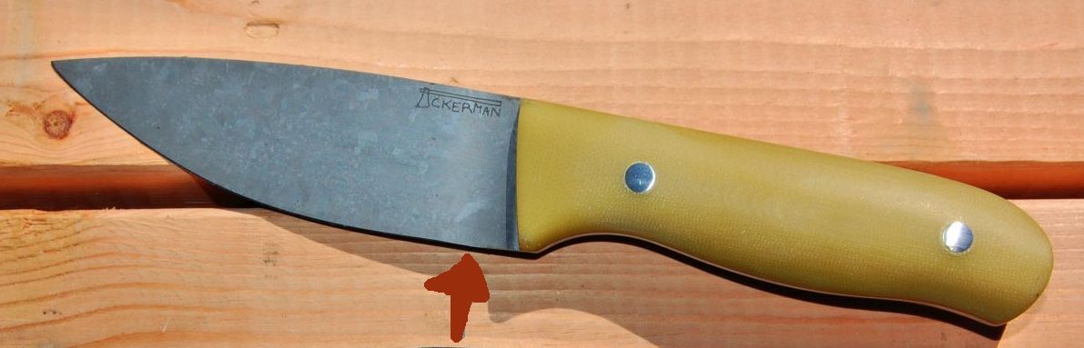

Re: Serrata
Have a look here...
The arrow shows where the edge begins...
Click on the image to make it bigger, and you will see the dendritic pattern on the blade.

Stuart Ackerman wrote: ↑Sun Apr 07, 2019 10:08 pmHave a look here...

That would be a deal-breaker for me. If the edge doesn't go all the way to the plunge grind, I consider it defective.Stuart Ackerman wrote: ↑Sun Apr 07, 2019 10:08 pmHave a look here...
This is where I would normally hold this knife. Note where the butt hits the heel of my hand.
This is where I end up to get the butt to a comfortable spot.
Yeah, my hands are that big.

I SEE the problem!!!!!
Remind me to never challenge you on anything you say or do! :)

LOL. I just thought you should know that there may be other issues in play besides the "440C ho hum".
