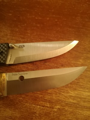

I do not believe s30v is an issue.
I have an EnZo PK70 folder with Scandi grind - Made in Taichung Taiwan - in the same factory as the Spyderco knives. So, this is a valid comparison.
Below is a picture of a 2' long board (6 inches wide, 1 inch thick) that was whittled into nothing. The box is full of paper and coardboard cut tests and the edge didn't dull/chip/roll through the process.
I do not feel it is a steel performance issue...

What wood?talesk wrote: ↑Mon Nov 05, 2018 8:11 amI do not believe s30v is an issue.
Re: Spyderco Puukko 2018
That was Red Cedar. working on a construction grade spruce 2x2 with a tonne of knots now to see how it holds up.Deadboxhero wrote: ↑Mon Nov 05, 2018 10:00 amWhat wood?talesk wrote: ↑Mon Nov 05, 2018 8:11 amI do not believe s30v is an issue.
I'm no steel expert but as a happy owner of both the pukko and the pk70, i can say that neither of the knives seems to have problems with any kind of wood growing in Norway. :)
But they are not my most carried blades so maybe there are some longterm drawback to This steel that i have yet to experience?
I did not know that the Enzo was produced at the same factory, that makes me like the pk even more.
Bladefinish is identical but the grinds are quite different.
