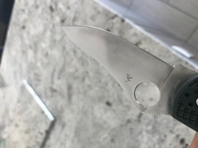

Here is a pick, not sure what caused this very specific patina. And only on one side of the blade.
Will that polish off or is it a deeper stain?
I have hit it with flitz a couple times and nothing, but that’s all I have tried. I don’t mind it, so no big deal.

As I look at my knife now, the grey patina is a little exaggerated in that pic. But, it’s still noticeable.
What really is the difference between a patina and a stain? I think of a patina as a layer that forms on the surface, while a stain is deeper embedded into the steel which is why it won't easily polish off. I may be completely wrong, that's just how it seems in my mind. I had a similar issue with S30V and my first Paramilitary, it had a price sticker on the blade for who knows how long and the glue stained a rectangle into the steel that never went away.
