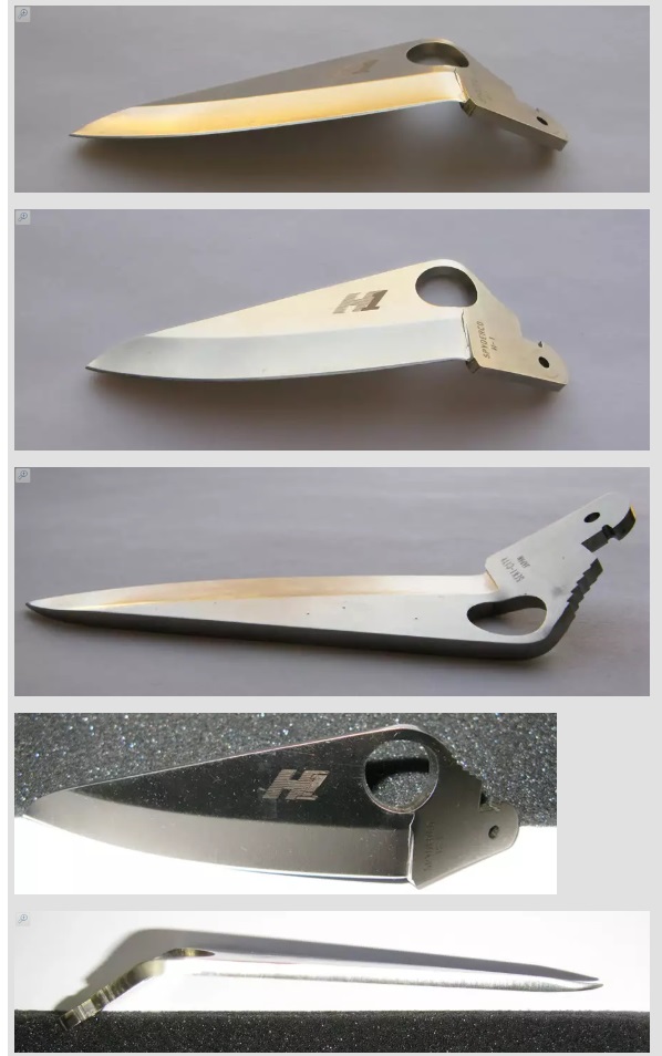

Do you guys remember seeing this blade? This has always stuck with me (btw not my knife or pics)
viewtopic.php?t=62419&start=20
