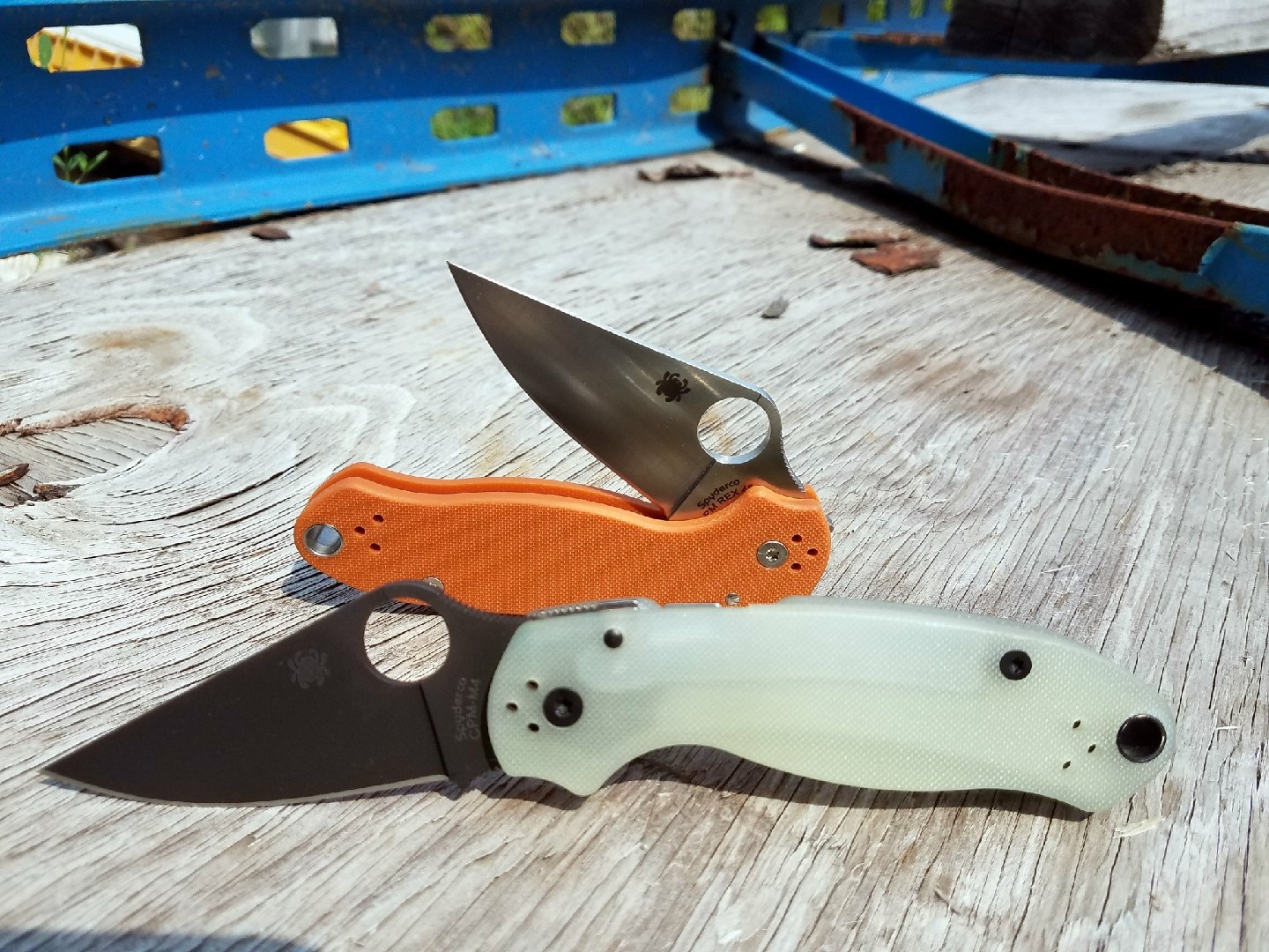

Was gonna turn this duo into a trio today with the Rivers edge version but I guess they'll have to wait for their orange rex brother to be berthed from the mail man.
