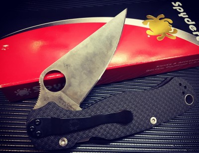

My first Spyderco: a Paramilitary 2 with 52100 steel and carbon fiber scales. I used apple cider vinegar to force a patina, and also attached a MXG Gear deep carry clip that matches the color of the patina on the steel.
Let me know what you guys think!

Looks nice, what are you thoughts on 52100 steel in general?

52100 is a great steel if maintained properly! The patina is a great start for rust prevention. I also keep the blade well oiled to further protect it from the elements.

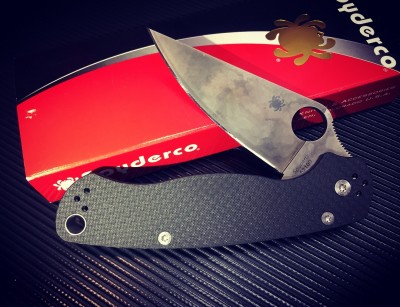

My version of a forced-patina. Started with a white vinegar bath to get the grey hue then moved to white wine vinegar to obtain movement. Then added balsamic vinaigrette for the rich colors. Moved onto another white vinegar to blend them all a bit. Resharpened. Viola. Thanks for your encouragement.
