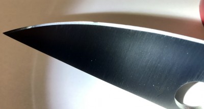

It seems like I am the fourth owner of a PM2 with M390 steel; when received, it had 4 areas where the original grind had been rolled/chipped (see below). I re-profiled it to 18 DPS and have not had any issues with chipping while cutting since then; I've been using it for about 2 months. :spyder:
