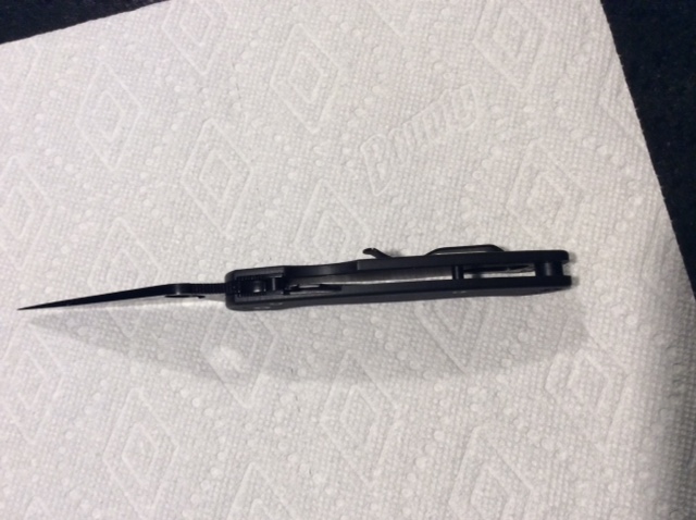

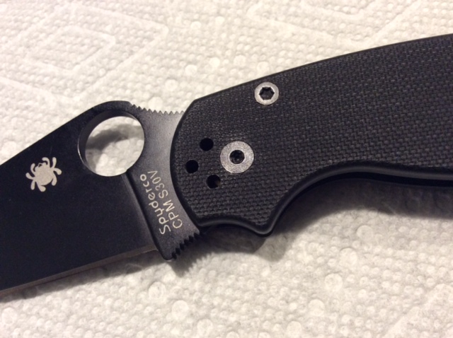

My first spyderco purchase was a PM2 from Optics Planet. My concern is with the thumb groove, looks like a fake based on other photos I've seen, and It also doesn't have duel cutouts. I've not held a real one so I have no comparison. Anyway, I was looking for opinions from those who are knowledgeable. Thanks!

Looks like a fake to me. The compression lock cutout isn't right, one liner should have one lightning cutout and the other should have two. The coating on the blade doesn't look correct either, but could be the lighting in the picture.
I'd return it and buy from one of the many reputable authorized dealers meantioned all throughout this forum.

The printing on the blade and the torx hardware looks different

The screws look like hex rather than torx.

Definite fake! Have you contacted Optics Planet? I would be curious to hear what they say.

Concuring with all previous posts: Fake....Adding an additional indicator that the lockbar of the real PM2 isn't blacked out on the black blade models
