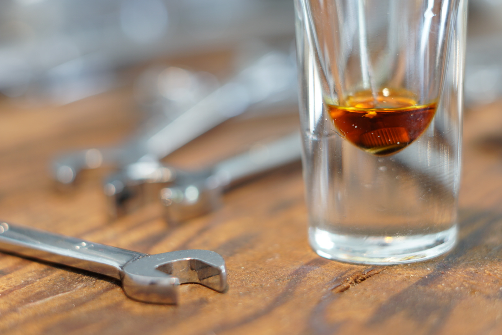

hom76 wrote:Very very nice finish!
How long did you soak the blade in the acid?
Thanks. I just did the liner and hardware while I had it apart. I started the blade with 5 minutes for the first acid bath. Pulled it out and it looked a little too light. Soaked for another 2 minutes and rechecked. Then gave it another 2min.

That is just lovely! What did you use on the pivot hole? Looks bubbly and I can't say I recognize it.
GIGANTORE
Posts: 33
Joined: Wed Apr 05, 2017 5:16 pm
Re: New Roc acid/stone wash and polished G10 scales
Post by GIGANTORE »
Thanks guys. I used clear nail polish on anything that was metal on metal. Stood up just enough to keep those areas from getting the affects of the acid.
