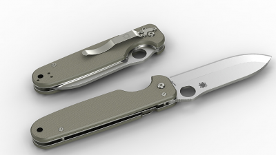

So before anyone gets too excited (if anyone was going to :-p) this one actually doesn't exist. It was a design I proposed about 6 years ago that didn't go anywhere. I stumbled on to my old CAD drawings and figured I'd share them. I had contracted with a buddy to turn my pen and ink designs into more professional CAD images and not only did he do the CAD work, he also did some amazing 3D renderings of what the designs would look like. Thought people should see his work
The SpyderMonkey was one was my folding bushcraft concept using a 3.5 inch spear point blade with Scandi grind, compression lock and G-10 scales. It was basically a folding version on the fixed blade Bushcrafter I designed for Blind Horse Knives/L.T. Wright Knives. There are a few folding bushcraft knives out now but at the time there really wasn't much if anything available.
Makes for some pretty wallpaper at this point anyway :-p
Happy Thanksgiving guys!
Tim

tstetz, I don't know much about designing or bushcraft, but this looks great to me. Your buddy's renders are excellent as well!

That looks way too stylish for bushcraft. Would make a nice edc though.

I like the design. One suggestion I would have is to move the choil forward so it it sits under the thumb ramp. I have found this give much better control and feel for me in making cuts.

Flat grind would be better for most folk, though...

Agree with this, never liked scandi grinds on folders (not overly fond of it on fixed blades either and I'm a Norwegian having grown up using them..) It works fine with thin blade stocks (2-3mm) though..

I'm not entirely opposed to flat grind although half the point at the time was that there basically weren't Scandi folders so that was a lot of my impetus. There are a few around now at least. And I know Scandi is something of a niche following (I still want one :-p ). I think it would have worked as a saber or flat as well but my initial thought was for the Scandi.

The reason that there are not many Scandi grind knives, especially folders is because the market for them is not very large. The Wolf Spyder project took a long time (years) and the power was the Ray Mears name. We've done a few Scandi models, but they are not very hot. Investing in bringing a new model to market is quite expessive and the market size must be considered before beginning.
You might reconsider your design?

Yeah, in hindsight I definitely wouldn't be wedded to a Scandi grind. 6 years ago it seemed like a good idea :p I can absolutely see that that a more conventional grind would be more appealing to most customers.
I have (slowly) learned over the years that just because I like something doesn't mean it will have broad appeal. I have quirky tastes :D
