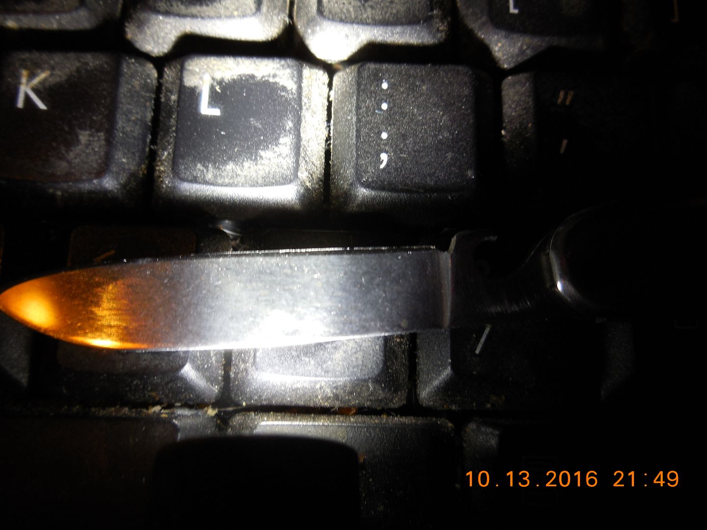

yablanowitz wrote:If you don't have fingernails, try using a toothpick. Alternately, shining a bright light across the flat of the blade from the spine side might show you the rolled edge. It will catch the light and reflect it back. I don't know if my photography skills are up to getting a good picture of it, but I'll see what I can do.
Edit to add: okay, not a very good picture, but you can see the bright line right at the edge where the edge is bent over (rolled). From the other side, you don't see that bright line.
Oh ok. My edge never looked like that. So I'm guessing it wasn't rolled.
