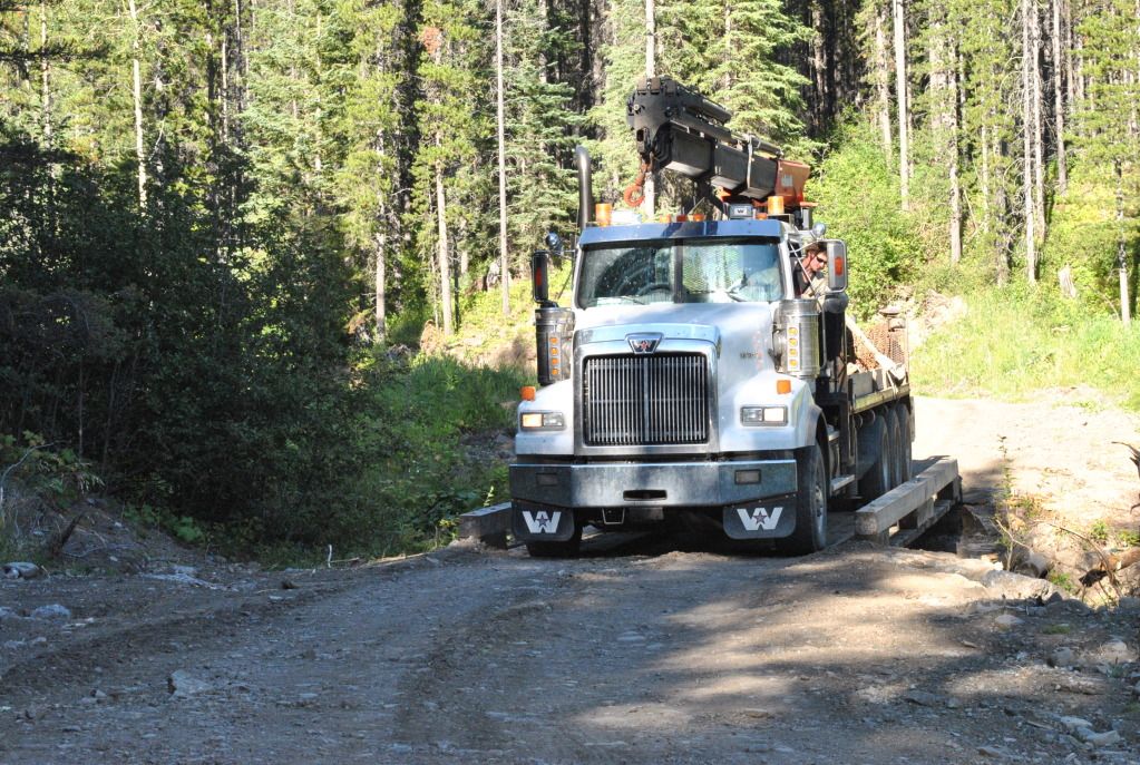

In the movie world something like a car with no brakes on the highway might make sense. In reality however, you use your brakes to stop your car after reversing out of your parking spot, and if someone cut your brake lines you'd just reverse into something and immediately know something was wrong before you even made it out of the parking lot/parking garage/wherever you park your car. You'd almost certainly never make it to a highway or to anywhere that you'd be at enough speed to cause any serious harm.
Now, losing your brakes for reasons beyond tampering will almost certainly be more of a problem. On large trucks with air brakes if you lose air pressure your brakes will "Dynamite" which means they'll lock up completely, but the drums can also glaze over if they get too hot, and they may not be able to stop the truck on a steep grade even with full brake pressure. This is only typically an issue on very steep grades like mountain passes and there are typically "Runaway" lanes that are filled with very loose and deep gravel that will scrub speed off an uncontrolled vehicle very quickly in order to stop them safely if they lose control of their braking ability. I drive a large truck, not usually in the mountains, but every few months and I'm always aware of what I'd need to do if I lost brakes.
Your initial question is a little vague...the movie scenario is completely manufactured for television and not realistic in any way. Real life scenarios are a little more situation specific. I've been in situations where I've been sliding towards the vehicle in front of me (On black ice) and turned into the curb to be able to stop. Worked fine and prevented an accident. If I was on a country road (I live in the country so I'm always prepared for this), I'd hit the ditch and take out someone's fence before hitting a stopped car because I can fix a fence easily...paying someone to fix someone's car and the added insurance costs would hurt me a lot more, not to mention the possible injury to anyone in a car that I might hit. I'd much rather hit a fence.
