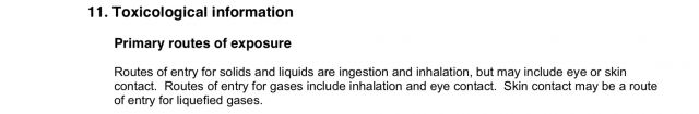

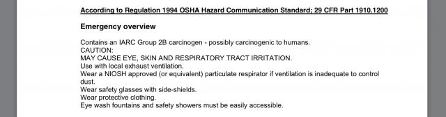

I don't know to much about raw G10 and his toxicity ?!
Doing it outside with a big respirator and gloves should be save enough.
But again, I guess the scales should be sealed with something at some point so it would go back to the slip-side.

G10 won't need to be sealed, nor can you really do it. Sand it wet and wear a respirator.

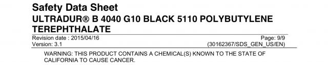

I stil wonder about the toxicity by contact with raw unsealed G10.
(I'll dig som research)

It is only toxic to inhale the dust. Once you are finished working on it there is no danger.Slone wrote:I like 180 on Micarta.Spydesense wrote:Something around 220 grit sandpaper will add some grip and get rid of the high polish on the G-10.
Don't worry about a bit of rust on the exposed tang, it is usually just a cosmetic issue. It will develop a patina (it goes grayish) with time and rusts less.

...I'm not so sure.NoFair wrote:It is only toxic to inhale the dust. Once you are finished working on itSlone wrote:I like 180 on Micarta.Spydesense wrote:Something around 220 grit sandpaper will add some grip and get rid of the high polish on the G-10.
there is no danger.
