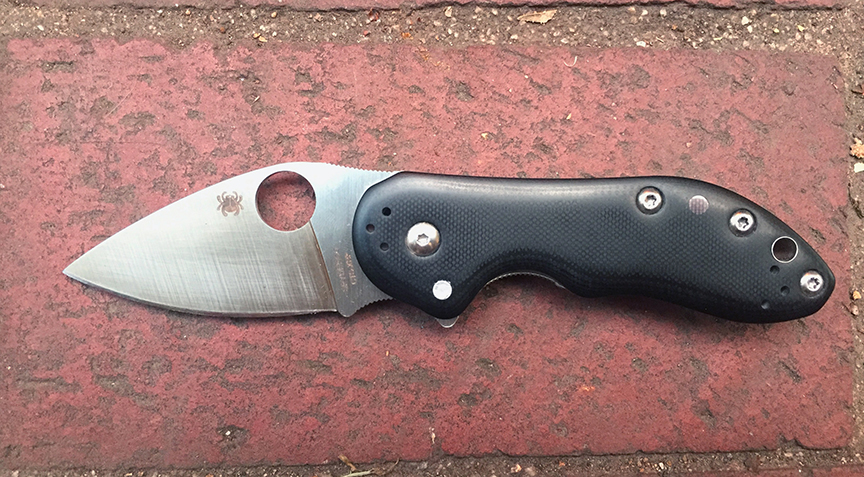

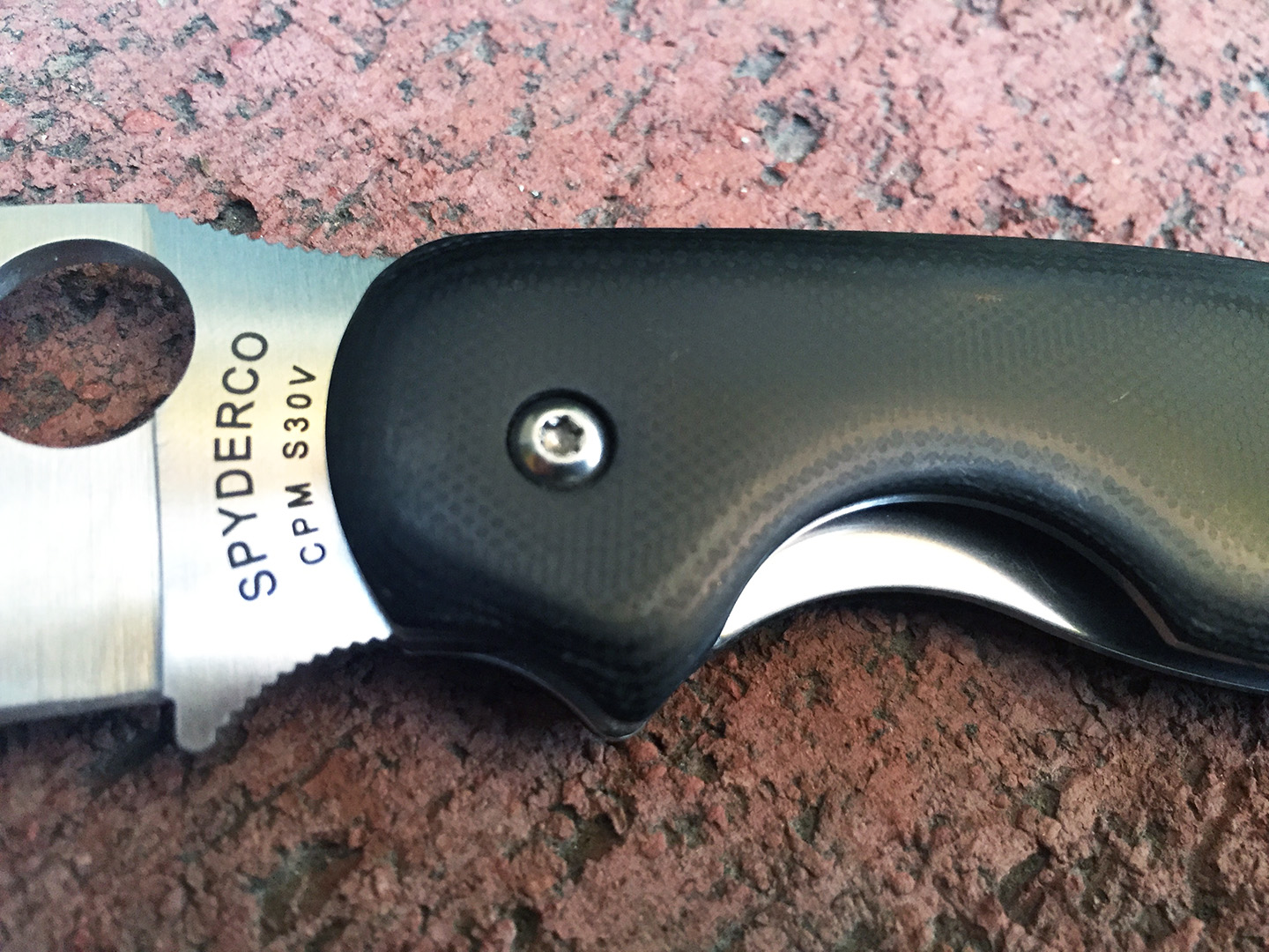

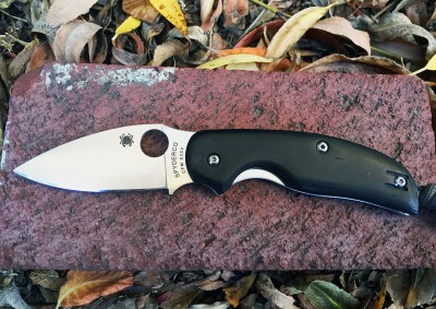

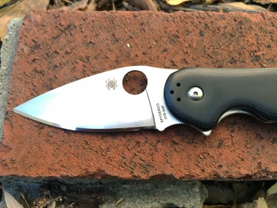

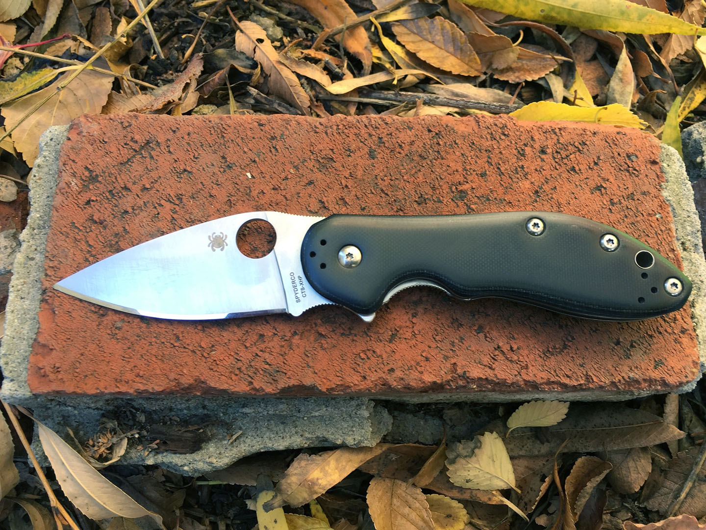

I've been channeling my inner Blackbeard and finding treasure buried deep within my peel ply Spydies - I'm in love with the g10 beneath the cf once it gets some sanding/buffing. Started with the Dice last week (documented in a previous thread), quickly moved to the Domino, and today the urge took me to get down on the Sage1. Here are pics, lemme know whatcha think:

Looks good.
I wonder what it would be like in Spyderworld if the knives came with multi-color or dual-color G10? (blue/black; green/black; orange/black; etc)

I'm a big fan of polished G10. If you take it up to about 3000 grit and polish it up nice, it looks pretty slick.

Not only that, but those photos kick-started my ghaw gene: gotta have a Wharncliffe
Beautiful work.

It was actually your old thread on that Kiwi that inspired me to try this. I'm going to 3000, that looks way too good- the grain pops out lovely!

Those look great, very organic lines and texture now!
Really digging it.

- yo Evil D, I took it up to 3000, and boom! you're right man, it really gets amazing at that grit. The pattern of the g10 just leaps out all of a sudden. Didn't notice too much difference at 2500, but at 3k its magical. thanks for the tip!
