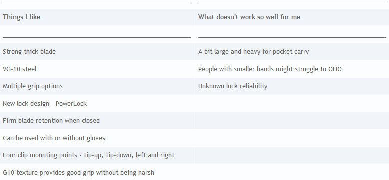

I would definitely agree with Sal, that the Tatanka is a bit large for urban everyday cutting tasks. Pulling this one out to open a package in the office gets a few funny looks, and I feel more comfortable with it in the great outdoors.
When heading out and wanting something more than your average folding knife, but not wanting to bother with a fixed blade, the Tatanka is easy to grab and gives you plenty of knife should you need it.
Good for fine tasks, strong enough for much heavier use, and large enough to take on most tasks, the Tatanka feels like several knives all in one. You might find it too large for a 'pocket' knife, but it easily slips into a pack or jacket/cargo leg pocket and is much less obtrusive than a fixed blade.
Review Summary
