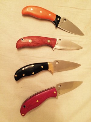

The four Mules (by the moment)
No por mucho tempranar, amanece mas madrugo

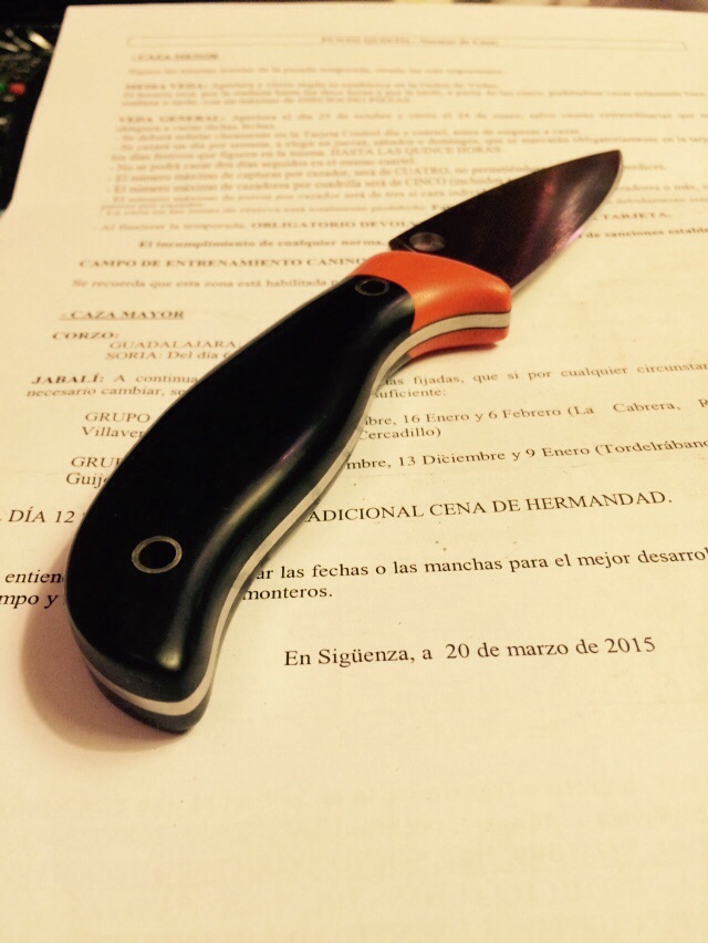

My next one will be an MT05 with Black micarta handle and orange G10 bolsters and two hole pins in nickel. Soon I will show here
