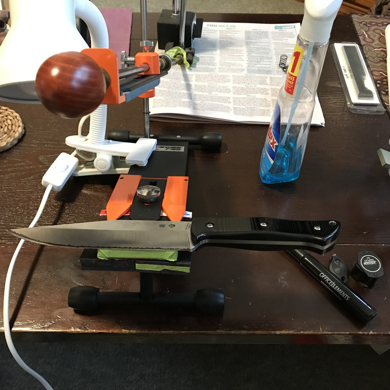

Nice Connor! Definitely takes some time with the CBN rods compared to that Hapstone! Nice progress so far.
- Posts: 5890
- Joined: Wed Jan 03, 2018 7:01 pm
- Location: Missouri, USA
Re: Community Sharpening Journal
Thanks! I worked on it some at lunch break. It's coming along, slow but sure.
- Connor
On the Hapstone, I concentrated on each individual scallop, one at a time. It went a lot faster that way. When using the Sharpmaker, my method was similar to what Sal demonstrated, but instead of going from heel to tip in one stroke, like he does, I used a sort of up-and-down method and slowly work my way from heel to tip over many strokes.Doeswhateveraspidercan wrote: ↑Fri Oct 11, 2019 8:46 amExcellent thanks for the write up and the pics. Please describe how you worked the scallops, is it like Sal shows on the sharpmaker video or within each one working back and forth within the small dish of the scallop while using the hapstone.
When I sharpen SE I go heel to tip, when I reprofile I do what you mentioned meat man, back and forth strokes. Seems to speed up the process.
- Posts: 5890
Yep same here. Do you generally use a microbevel when sharpening SE? That's what I had been doing, although I might try running without one for awhile to see how that goes. I like the easy touchups but reprofiling is a pain lol.
Anyway I think I am going to call it done. Nice and shaving sharp. I'm excited to be using serrations again.
- Connor
I've tried both methods. The black Pacific Salt I post I've never used a microbevel, the satin finish I do. I plan to grind it off though, for some reason I can't seem to get it quite as sharp as the black one without a microbevel. I think I'm going to try to get around to get this weekend, and if I can find my misplaced tripod I may make a video.The Meat man wrote: ↑Fri Oct 11, 2019 7:33 pmYep same here. Do you generally use a microbevel when sharpening SE? That's what I had been doing, although I might try running without one for awhile to see how that goes. I like the easy touchups but reprofiling is a pain lol.

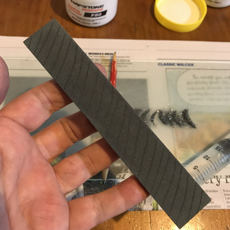

Hope someone might like to see how I flatten SiC stones. :)
It’s easy and makes a big difference I reckon. This is a 220grit stone I use to re-profile because I like the way it feels and it gives me a better idea of a particular steel’s wear resistance compared to diamond or CBN abrasives.
Anyhow, I like to use 80grit loose SiC to flatten this particular 220grit SiC stone. As you can see I have a few sheets off newsprint on a flat bench and a clean sheet of glass sitting on that.
I cross hatched the stone’s face with a pencil and saturate the stone with water if it’s porous or it’ll suck up the water you use with the loose grit on the glass.
Add a little water to the loose grit.
I use the face of the stone to disperse the loose grit over the glass. When I have an even layer of loose grit in an area say three times that of the stone I apply just enough pressure to feel the loose grit “rolling” (between the glass and the stone’s face) all while moving it in a figure eight and fairly random pattern. It only takes a few seconds with a previously flattened stone before all pencil marks are removed.
Give the stone a rinse with water and it’s flat, clean and sharp. :cool:

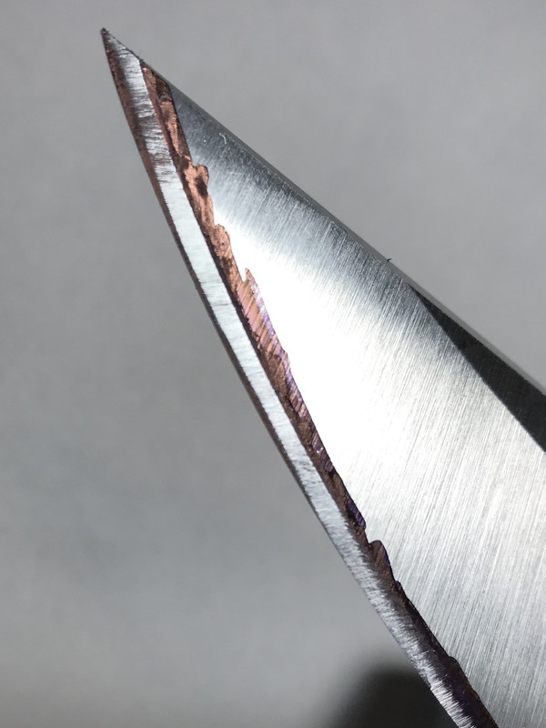

I damaged the factory edge on my Province a little, chopping bones and figured I’d give it a full sharpen. :cool:
Here’s the same stone from my last post. The stone feels great and at this stage I’d say cutting 4V fairly well.
I wanted to follow the factory edge as best I could but figured 4V with a the factory edge was pretty tough so I’ve set up to sharpen following the relatively thin grind from the plunge line to the beginning of the belly, the straight section of the blade. From there the angle thins more and more all the way to the tip, a bit more than it did from the factory. You have to love a fine tip on a knife! Ah, hahaha!
Here’s a bit of a view of the stones scratch pattern and you can see I’m chasing the last inch or two of factory grind from the tip back. :)
P.S. I was wearing an Optivisor yesterday, a bit careless and stabbed a glass vase just hard enough to bend the very tip to a tiny little barb. :eek:

Baron Mind, nice new stone. I like your choices in products. Did it not arrive perfectly flat? Or do you flatten all stones after each use (even finishing stones)?
RustyIron, what stone does Ken Schwartz recommend specifically for Maxamet?
Bloke, thanks for the mini guide. I'm going to pick up some SiC powder soon.

Great post about flattening stones. It's something I seriously need to do.
Have you ever flattened bonded diamond stones? If so any recommendations?
