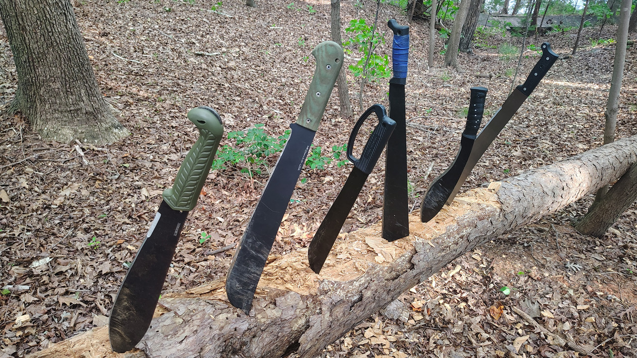

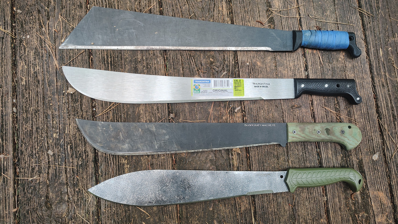

I'd like to see something along the lines of the condor terrachete with a thinner blade (2mm instead of 3mm) and Sal style ergonomics.
thin and whippy is what you want if you're using a machete as a machete. 3mm is the max I'd consider, and even then they start to feel a little heavy for foliage. 3mm is more of a hybrid machete / chopper - better for woods, worse for undergrowth.
It's about 16" which makes it comfortable to belt carry or pack carry vs 18-24" machetes that spend more time in the garage / trunk.
injection molded handle like aqua salts to keep costs down.
the sheath can be used one handed. it's plastic instead of fabric so more durable. I have pictures someshere.
blade isn't as upswept as latin style which works better for me
video on reprofiling mine. skip to last minute to see how it chops (16" blade 3mm thick)
bottom machete
far left
now condor does a dual grind on theirs. it might be neat to do the same to a spyderco one, except make the area close to the handle serrated for easily cutting rope etc. the thinner grind there would let it carve wood quite easily too.
I would go with 3mm if these are going to be made of stainless steel in order to add durability and edge stability. I feel like that would hit the sweet spot between enough flexibility and also some harder use.
And I really like the idea of some handles in the fashion of the Jumpmaster 2 in G10 or FRN.
It is pretty fun brain storming ideas amongst different folks.
